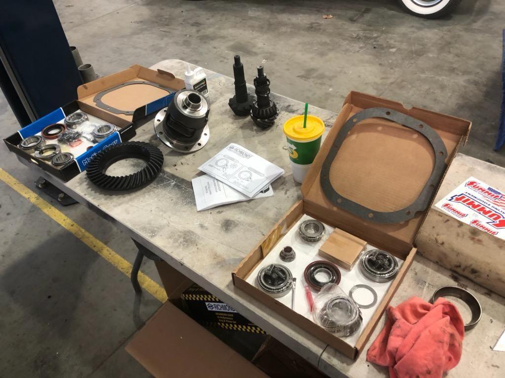

New ring, pinion, differential, axel bearings, every other seal, bearing and gear...

What gears are you putting in it? If they're still 3.73 don't be alarmed by some noise after the rebuilt. Best way to look out is to drain some diff fluid every so often into a clear container and examine it. If it looks cloudy or you can see metallic shavings it's time to be alarmed.
