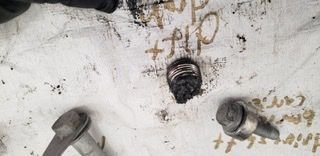

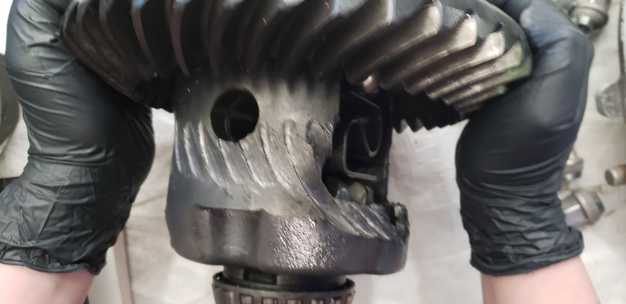

Old Nov 14, 2019 | 07:53 AM
Mogumbo's Avatar
Joined: November 13, 2019
Posts: 11
More Photos
Here, are a couple more. The photo of the bolt looking thing is the drain plug, which is magnetized to catch metal bits... it's pretty much loaded to capacity.
Also, pinion gear marks on differential housing - obviously not the way the rear end was designed to operate. Shows how far pinion had worked it's way into the housing before obliterating the diffential.

It's a relatively simple matter to pull the back cover on the differential and check the backlash and the wear pattern on the gear set. Backlash is best checked with a dial indicator at 90* increments around the ring gear. An experienced mechanic will [ should ] have a pretty good sense of feel for clearances so if it's really off the dial indicator won't be necessary, but still the best way to do it. If everything is OK with the clearances and the pattern isn't really off, you'll either just have to live with it since once the pattern has been established changing things is generally fruitless and may even make it worse, or replace the ring and pinion with a new set. Bad pinion or side bearings can also be source of noise and can make a whining or howling sound. Usually it's the pinion bearing that does this. You didn't say anything about rear control arms. Are they stock or aftermarket? Stock arms have rubber bushings that allow for a bit more movement, but they're also better at damping noise. Poly bushings tend to transmit sound and heim joints [ great for racing ] are even worse in this regard. All rear ends generate some normal noise in operation and aftermarket arms can transmit this and make you think something is wrong. It can take an experienced ear to know the difference between the beginning of a real malfunction and what's normal when the car has aftermarket control arms.
