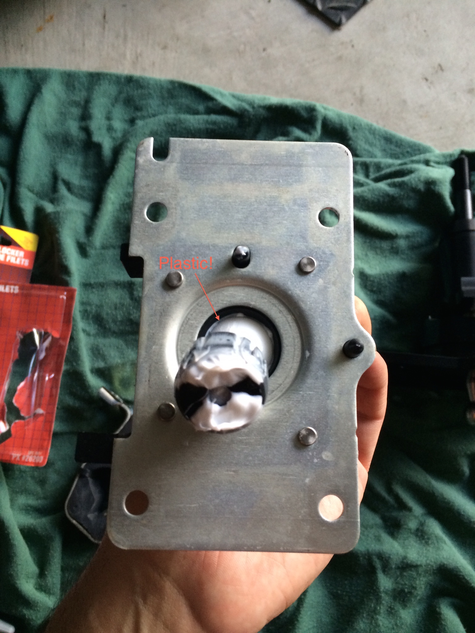

first things first. - SAFETY!

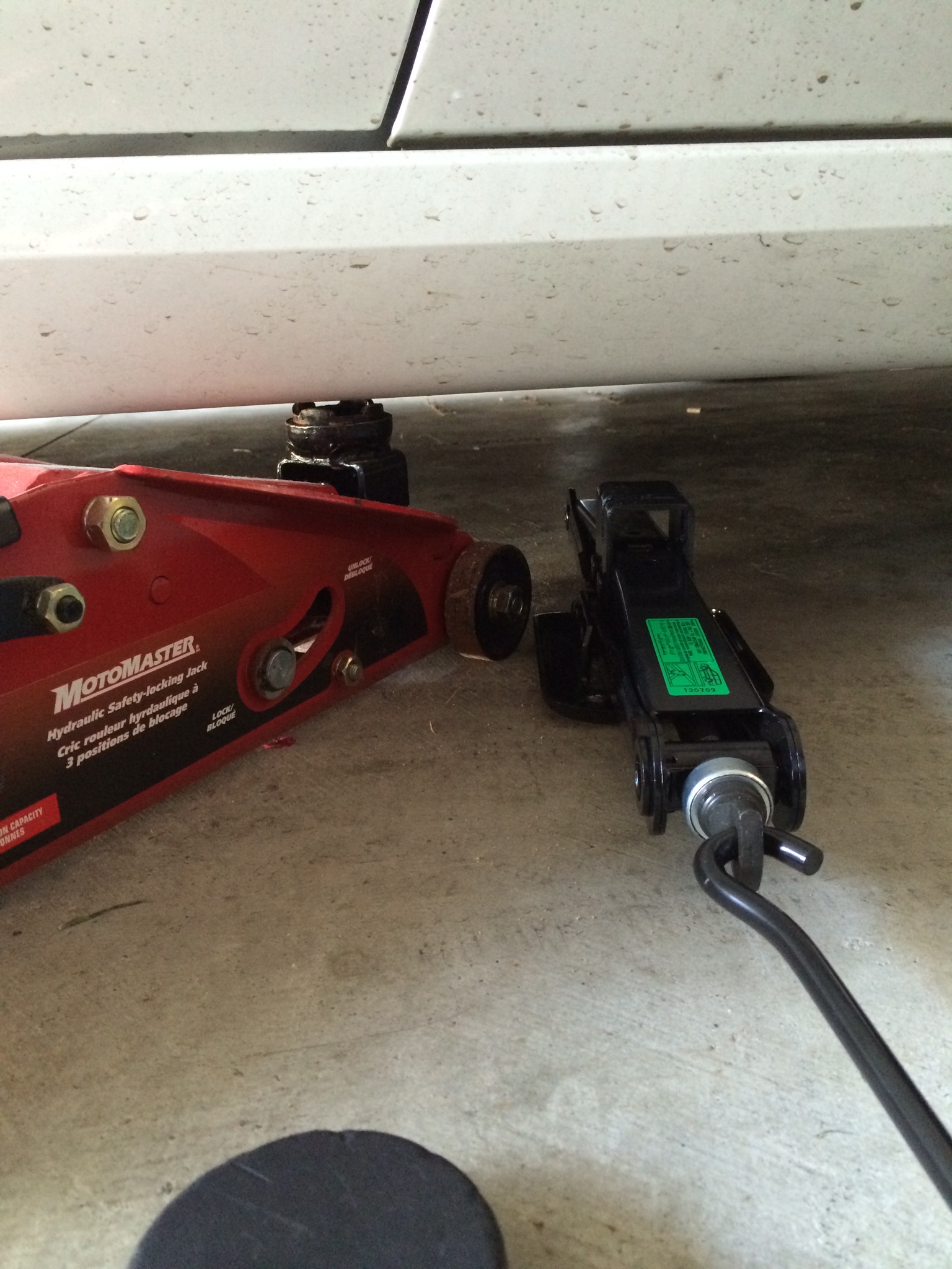

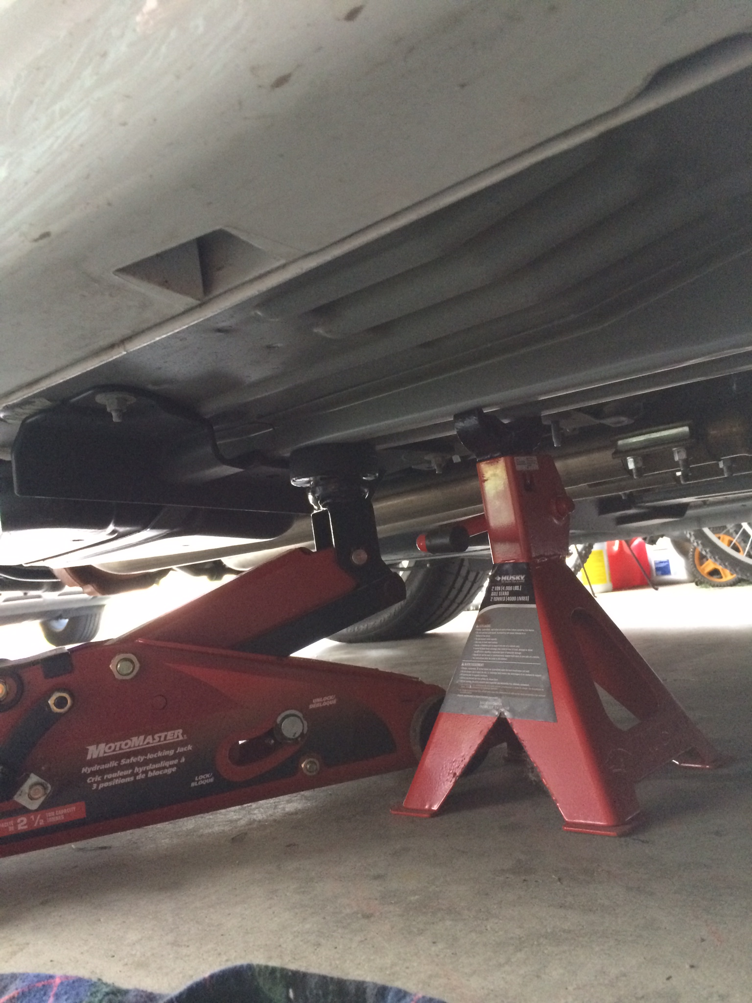

My hydraulic jack didn't really clear the bottom end of the mustang.
So, I went and got my wife's Santa Fe jack.... was able to get underneath and lift the one end and then used my hydraulic jack to lift the other side.
It was a tight fit wiggling underneath the car with all of the support / jacks holding it up. I didn't want to take any chances regardless

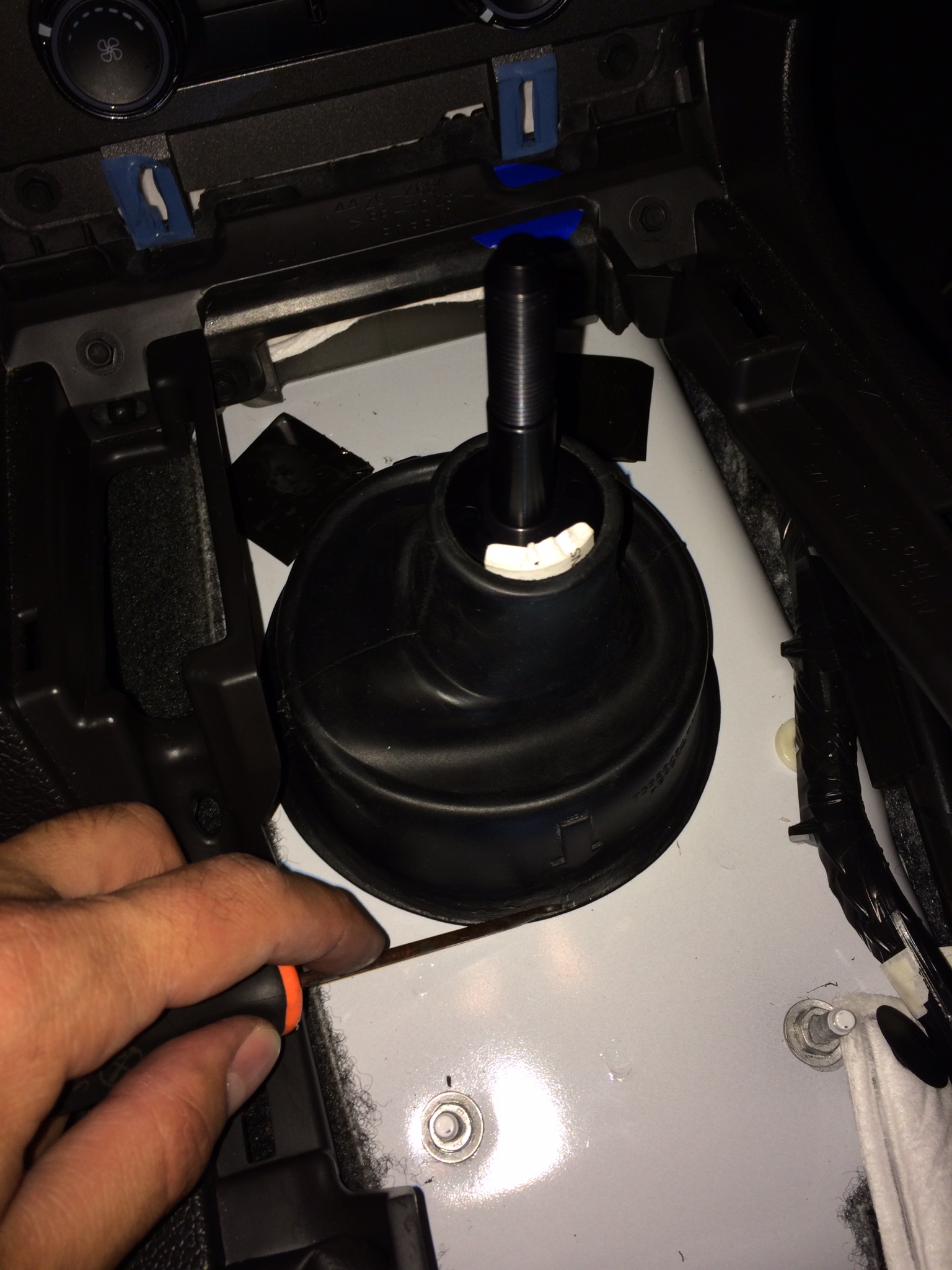

It took no time at all to pull the stock bracket off and remove the interior cabin and stock shifter **** out and remove any insulation padding.

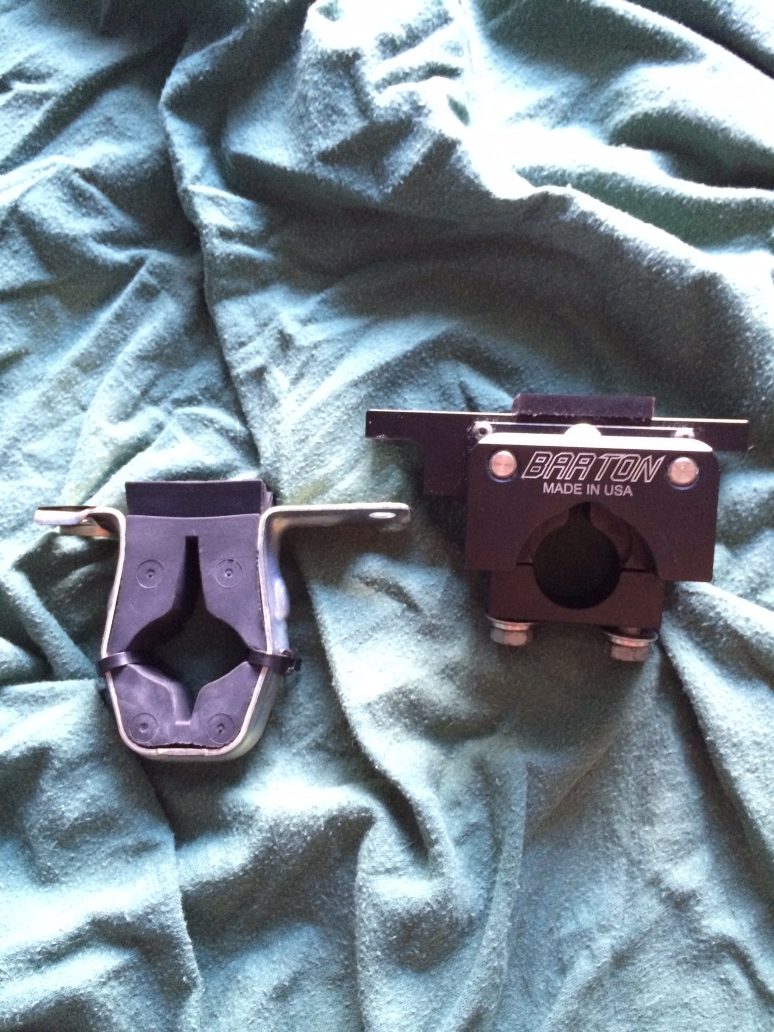

we ALL know the factory bracket on the mustang is a joke.... it really does nothing for any spirited driver that likes to give it a little extra oomph every now and then.

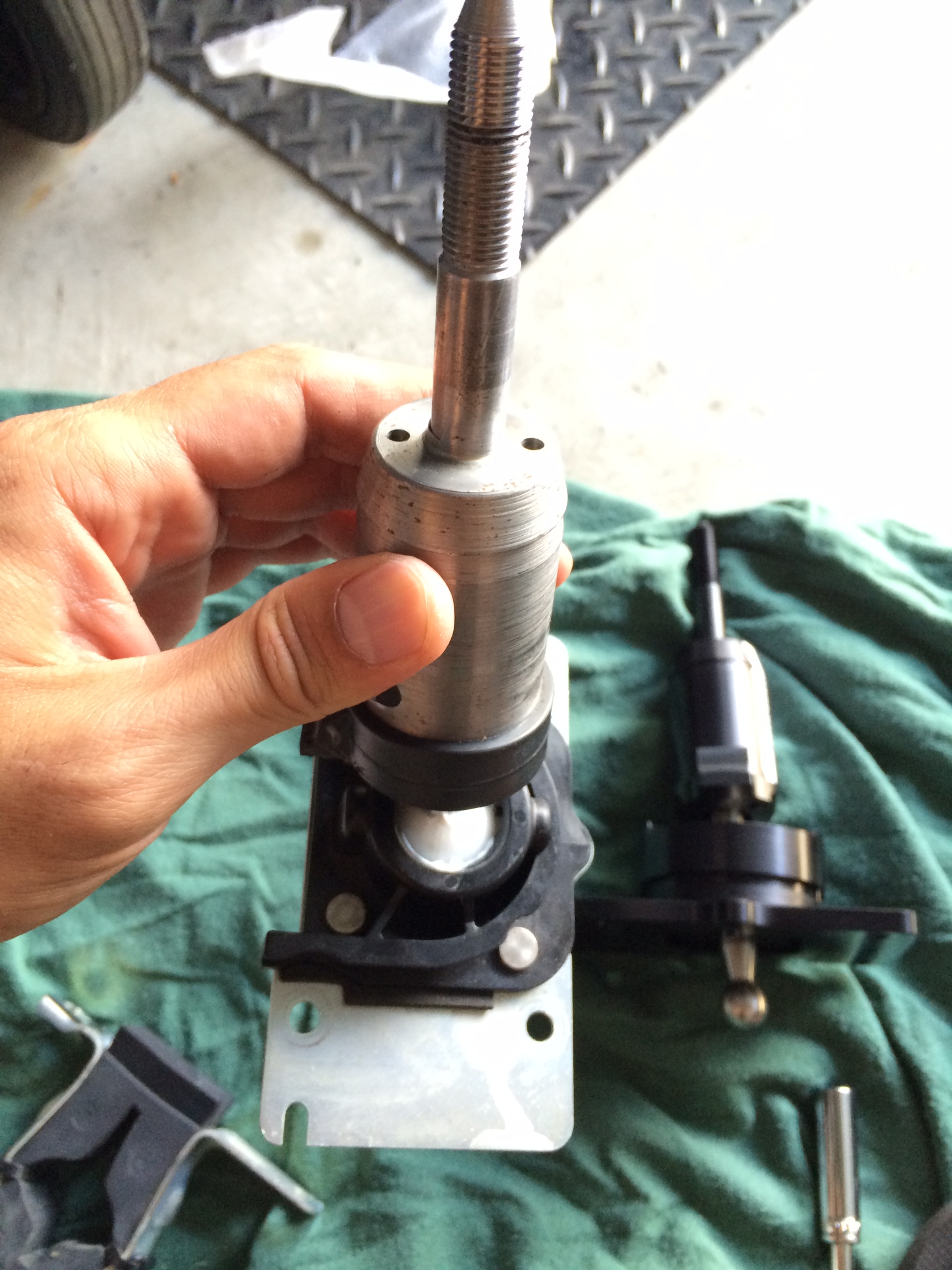

the quality between the Barton and Stock shifter to me, there isn't a whole lot of difference except for a couple of key components.
The barton has ZERO plastic components (unlike the stock shifter) the Barton shifter feels like its much more durable and better built.
I had everything pulled apart and "dry fitted" in and around 1.5 hours.
I had an issue where i was scratching my head for quite a long time. The shifter was perfect except that it wouldn't allow me to shift into 2nd.... I was baffled for a while. I needed up backing out ALL of the screws in the shifter and the 2 post bracket and in the end, it was my fault for not paying attention to detail.
Other than that. the install was straight forward (given that you follow the guides)
In the end, I really like how precise the barton shifter is over the stock shifter. its bang on and direct no matter what gear you're in. I found that theres no hesitation like the stock shifter.
That said, i still didn't mind the stock shifter. its really not bad for anyone who really just wants to drive the car and not beat through each gear.
this is the link to show you the throws with the barton shifter.
and the stock shifter.
I've found that you do you to kind of armstrong the shifter into reverse which is a little more effort, but not a bad thing.
I have found a little more NVH noise over the stock shifter. Not a big deal. I don't really hear it after being in the car for a few minutes and or if the stereo is even slightly on or windows down. its fine.
Yeah - Im sure the MGW shifter is better in a lot of ways. I wasn't prepared nor willing to rip it all apart to do and spend almost double (don't forget, i live in Canada) to get it.
I'm really happen to have done this and gotten the Barton shifter & 2 post barton bracket done.
Hope this helps you guys that are still on the fence about replacing your stock shifter.
