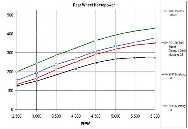

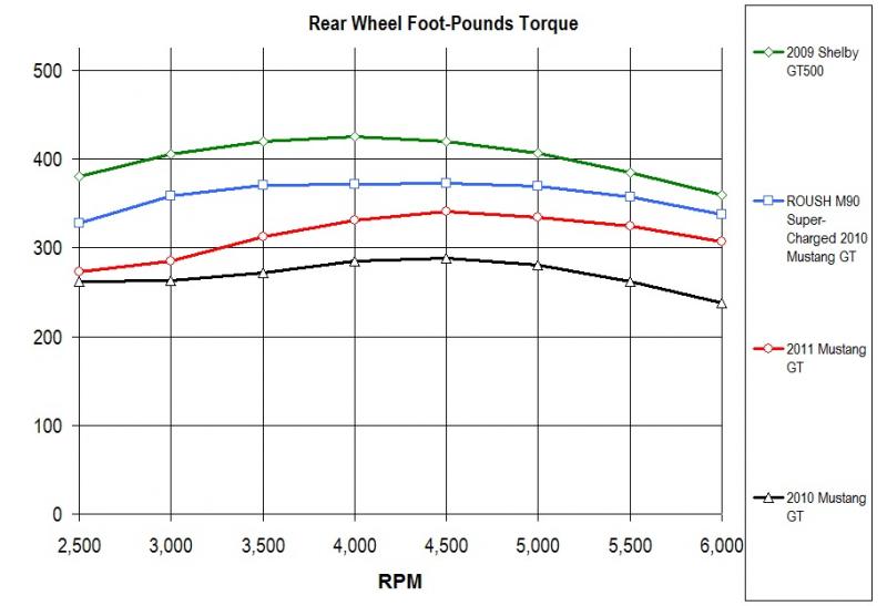

OK,
After lots of long searching I have found a chart that reflects the the Mustang engines/configurations I wanted to know about. I did not answer my own question as good as I hoped, but maybe this will be useful to others who are curious...
A few points to remember about the graphs:
-I do not know what boost that the Roushcharger is at on the pull in blue, nor do I know how that blower is compared to the Edelbrock one that I favor.
-I do not know if all these were done on the same dyno with similar conditions, though I do know they were all done on the same BRAND of dyno.
-The 5.0 have different gear ratios than the 4.6 so one would hope to assume the final drive ratio of 1:1 was used during the test.
- The person who compiled this said all results were production cars with manual transmissions on Dynojets, through the factory airbox and SAE corrected. Average of 2 cars for the 2011 GT result, and 5 cars each for the rest. He pulled the numbers from various dyno sheets, so not an exact apples to apples comparison.
Those dyno charts for the 4.6 is with the small M90 blower, not the TVS2300 which makes considerably more power and torque. The TVS2300 is more comparable to the edelbrock or saleen in it's power capabilities.

According to the late Carl Shelby, Horsepower sells cars but torque wins races. From the comparison graph, the torque curve for a mild blower on a 4.6 is above that of the stock 5.0. Question is can the driver make use of that much torque down low or will it all go up in smoke during the first 60 feet. In practice would a 5.0 be able to walk away from a blown 4.6 on the highway? I am thinking not.
