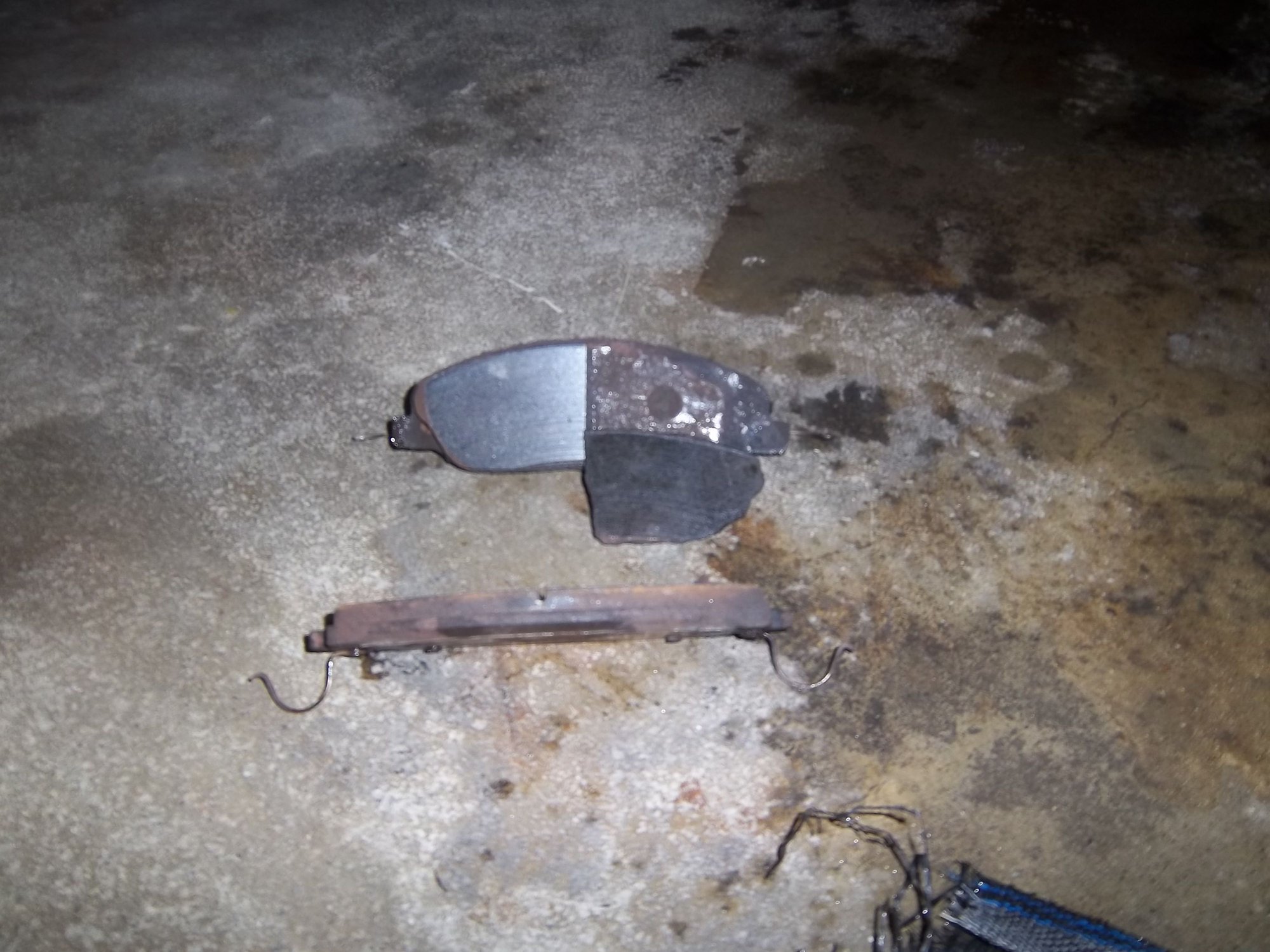

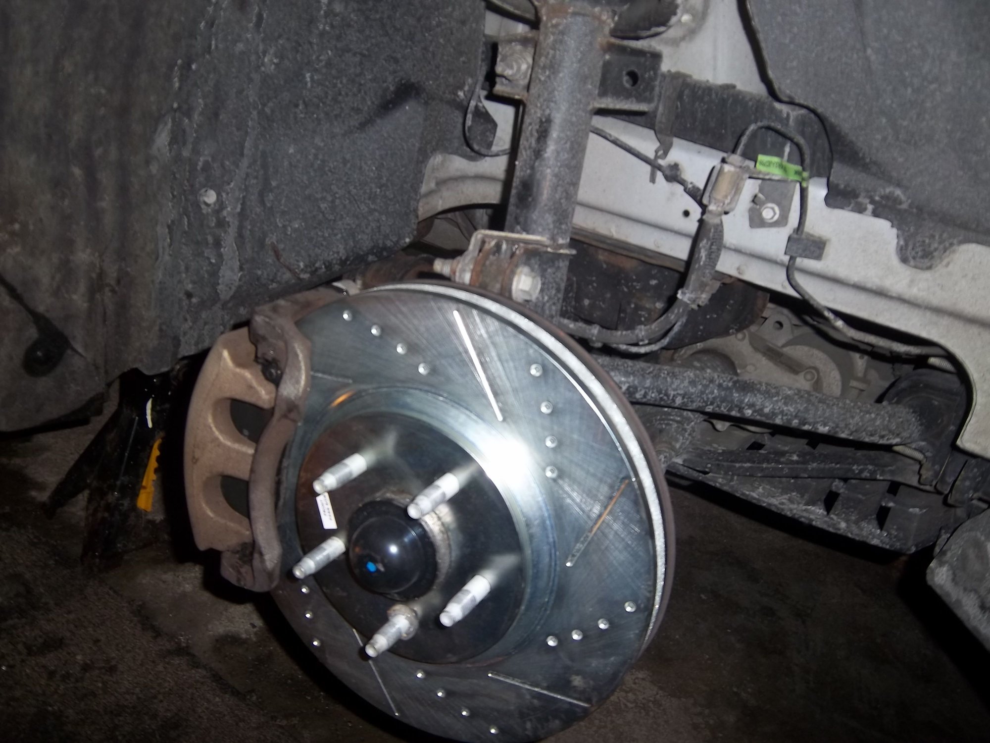

I just replaced fronts with American Muscle Z23 pads & rotors ( slotted & drilled)
Will replace the rears with the same Z23.
Have 75,000 miles with room to spare on the pads --- but ... I decided to change anyway. Turns out one of the pads was broken See attached photo.
Hershey
Broken pad.
