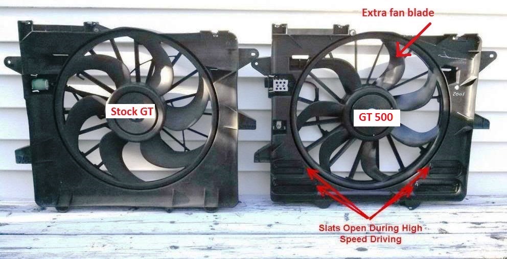

A GT500 fan might be an option for you. They are available from Ford Racing or your Ford dealer as it’s a OEM part. Check with the online vendors as they usually have better pricing. It was a plug & play swap for my stock ‘14 GT fan.
http://fordperformanceracingparts.co...KeyField=23200
Good idea John.

Rich, I seen that review and think the owner was talking about the steering reservoir not fitting with the GT500 fan and SVE radiator. The GT500 fan was direct swap in my ‘14 GT, no modifications were needed as I retain my OE radiator and OE coolant reservoir. American Muscle has some GT500 fan reviews:
