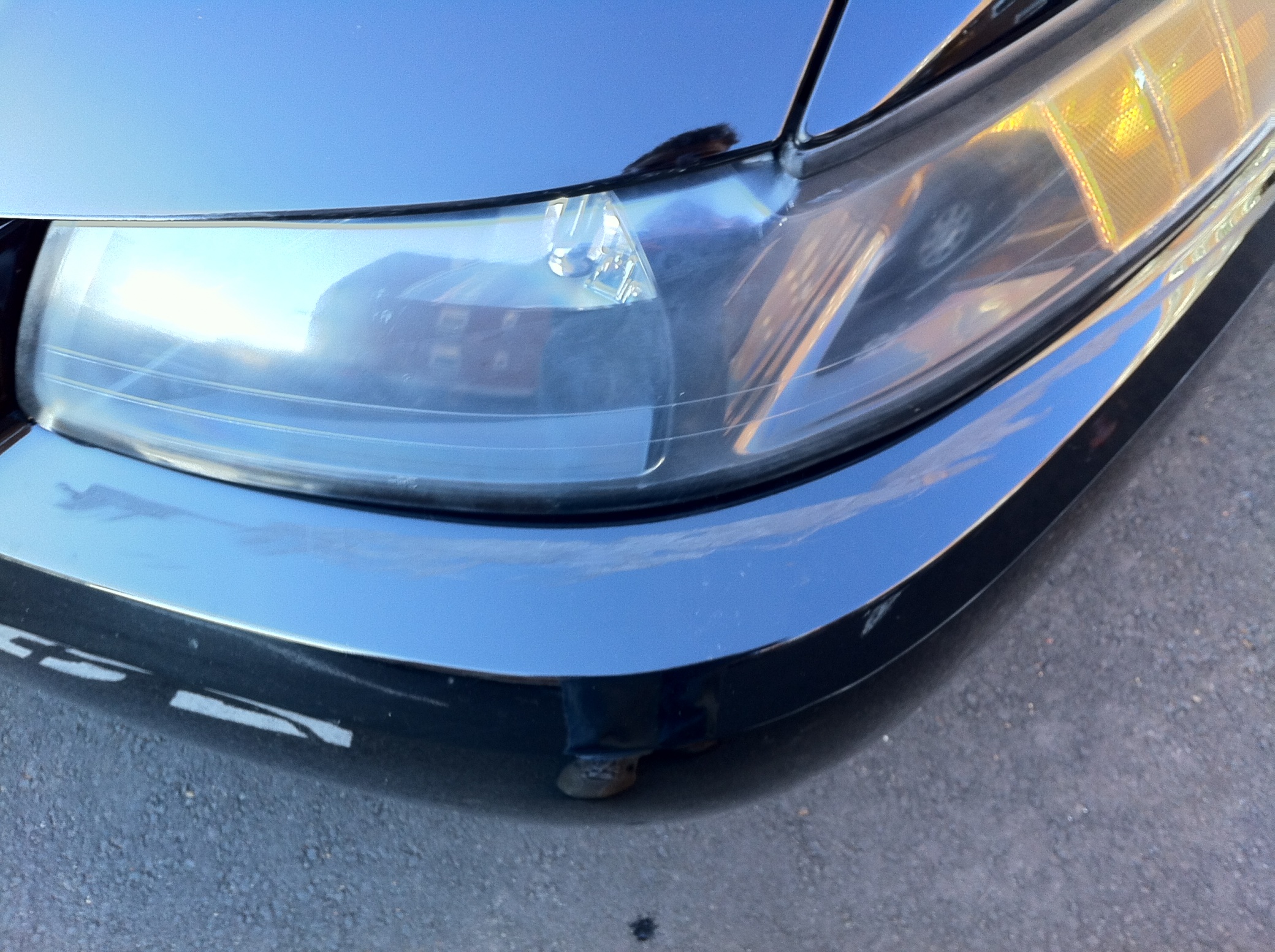

Attached is a picture of what I did to my beautiful car. I was using a headlight restoration kit and didn't protect the area around the headlight with enough automotive masking tape. What an idiot!

Is that from the sandpaper?

From a sanding disc yeah.

Yea that's not good. You know our headlights pop out real easily right? L shaped rods just pull on em.

Hah well I know now. It's just a scuff- it's not like it's that deep. What do you advise I do?

Buff it out. Its not easy but its not hard. Just tricky. Best bet is to find a local detail shop and see what they'll charge you. Not much probably. Might as well do the whole car. Or you could try rubbing compound. Go to the car care section and search buffing, scratch removal etc
I've never tried to buff anything simply because the amount of damage you can do by not doing it right

Yeah I don't really know what I'm doing so I'd be the one who does more bad than good. I'll try MAACO or try to find a local detailing shop, not sure of any around here though. Thanks for your advice and let me know how you make out.

I can't tell how deep it is but that should buff out ok. I'd guess a combo of heavy cut cleaner and show car glaze would do it. Can get them at just about any decent chain auto parts store these days. There are some grades of less abrasiveness than heavy cut and those might work too. use the heavy cut or other to smooth out the scratches and then the show car glaze to polish it out. I've made keying look decent or even vanish with this combo. You might get by with show car glaze alone.
Meguiar's M0416 Heavy Cut Cleaner & Meguiars Mirror Glaze #7 Show Car Glaze
