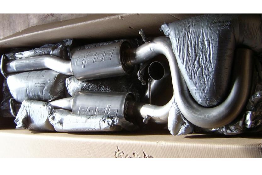

I ordered the Stingers online and they arrived to my door 3 days later, very well packaged with all parts included and detailed instructions.

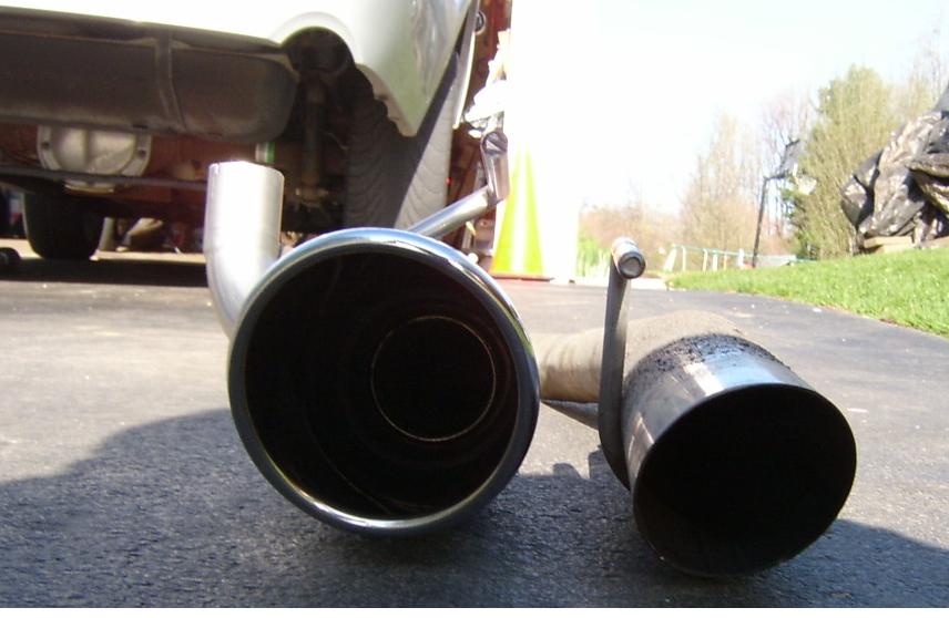

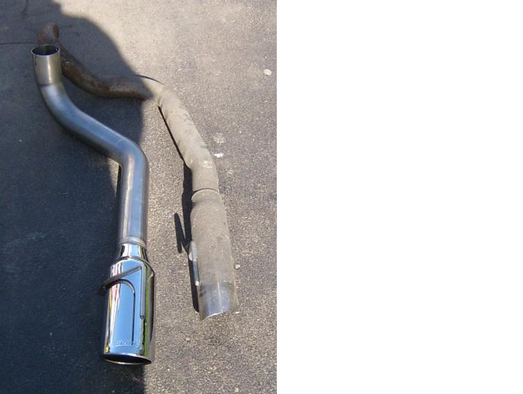

I placed the car on jacks and there was just enough room to fit underneath the car. I started by cutting through the stock exhaust with a reciprocating saw just above the rear axle which took seconds to do. Next I started to work on the bolts which fasten the stock H pipe to the mufflers. 4 bolts, just 4 bolts, what a PAIN!!! Once I started I realised that corrosion had been quite happy under my car. They would not come off for anything, breaking wrentch, airgun, big hammer, nothing. In the end I resorted to the cutting wheel and cut through them. Limited space made this a pain. I cut through one of the supports for the mufflers so that I could twist them out of the rubber hangers, this made it much easier to remove.

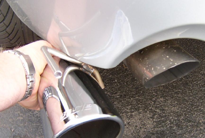

With the old exhaust gone I could put on the new one. After driving for an hour to the nearest open hardware store for new bolts (just happen to work there = discount) I crawled back under the car. Placed the new insert section which joins to the muffler section (slides inside then sealed with clamp) up to the H pipe fittings which were a perfect fit, hand tightened the bolts and located the muffler section in the rubber hangers which were lubricated well to help get them in. With this in place I attached the tailpipes into the hangers and joined them to the muffler section with the clamps. I tightened the rear sections then the front sections. Ta dah. Fitted the Stingers. Started up the car and it scared me. Didnt realise quite how loud they were. Woke up the neighbours.
I didnt regret fitting the stingers myself, however the install took almost 4 hours from start to finish. This was due to the problems I encountered. I know that had I had access to a lift/pit and forseen the seized bolts then installation would have been done in around 45 minutes, quick and easy.
The quality is fantastic and my concerns over the fit were forgotten. This system works great and fully adjustable. The only problems I found were the bolts I had to cut and sliding the front section over the axle which wouldnt have been a problem if car was on a lift.
