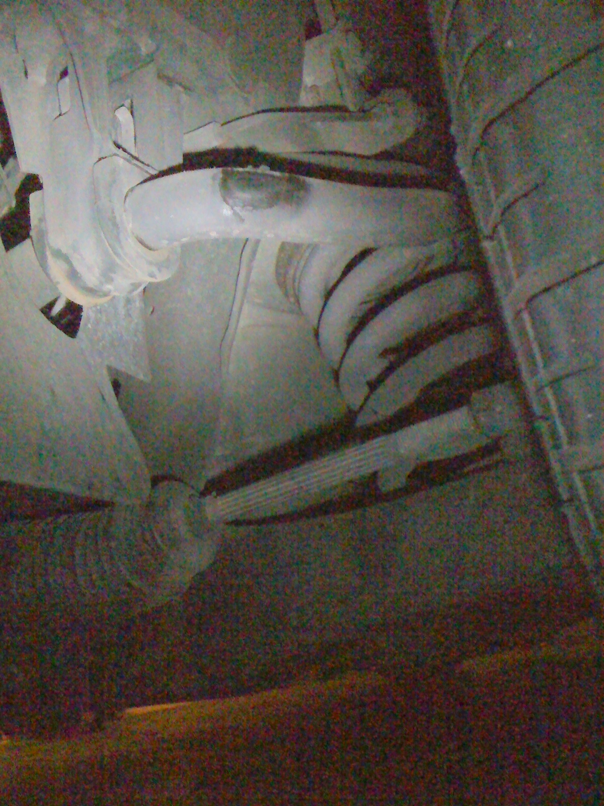

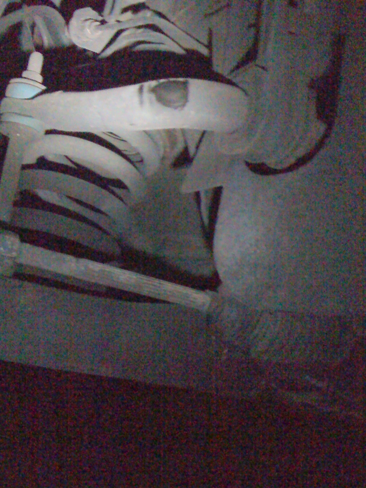

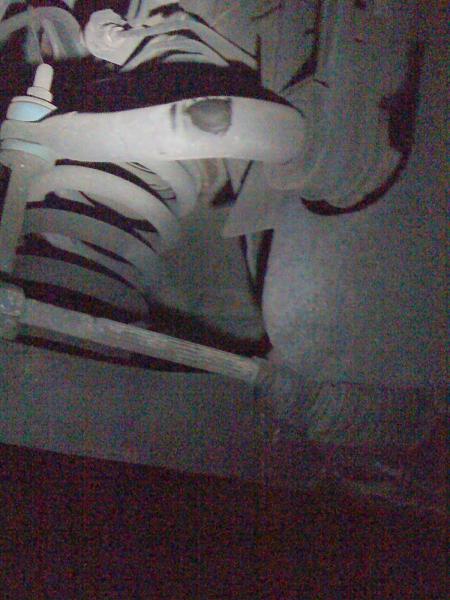

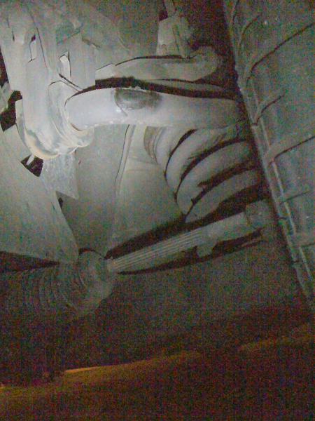

Rub Marks
Can you guys analyze these rubs marks I have on both sides . . .. . . what do you think is rubbing?

Old Jan 7, 2010 | 12:23 PM
Do you have slightly over sized tires on your car Leonard? That is usally what will cause that when turned all the way.

That is exactly what that is. Your tires are rubbing when in full turn. Mine do the exact same thing.

thank you guys . .. . . the only problem is I have stock 01 Bullitt wheels? Do other 01 Bullitt owners have this problem? I can't imagine Ford would sell this condition? Or maybe yes?

you could still have larger than stock tires on the stock rims, whats the size? It just looks like the tires were making slight contact while at full lock

I just checked the tires . . . . .yes it looks like the previous owner put non-OEM tire size on the Bullitt OEM wheels. I have 235/50ZR17 . . . . .. . according to the goodyear site the OEM size is 245 45 ZR17. Could the higher profile tires cause the rub and the full turn sound? I need to change the tires anyways . . .. .
