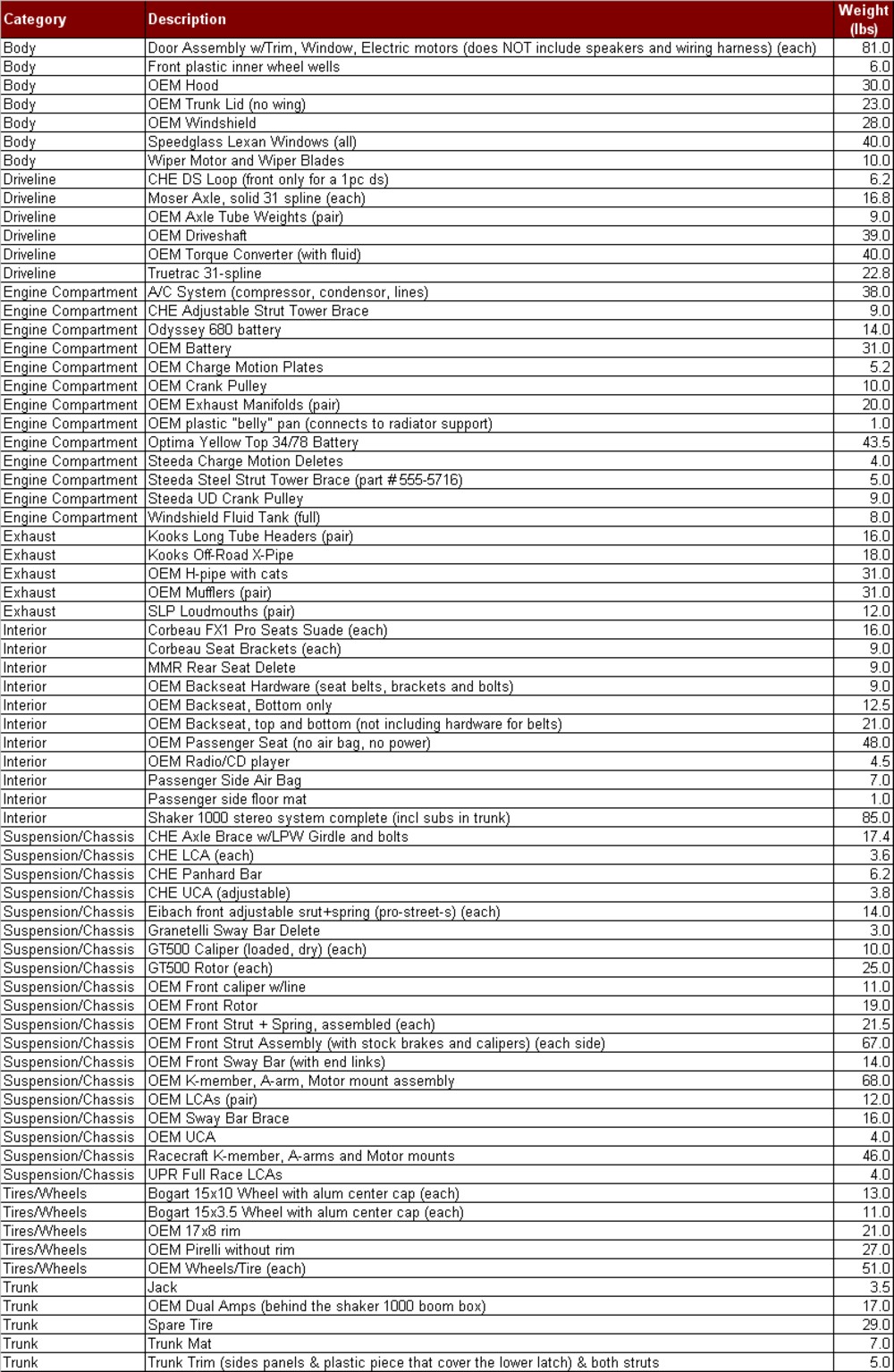

Originally Posted by mtchstng
Thanks! wow, that's a lot of junk in the trunk, wonder what all that weighs........
Weights for the amps and the whole system are on the list..

Thanks guys. 85 lbs? I wouldnt of guessed that much. lets see 100lbs is a tenth in the quarter....
