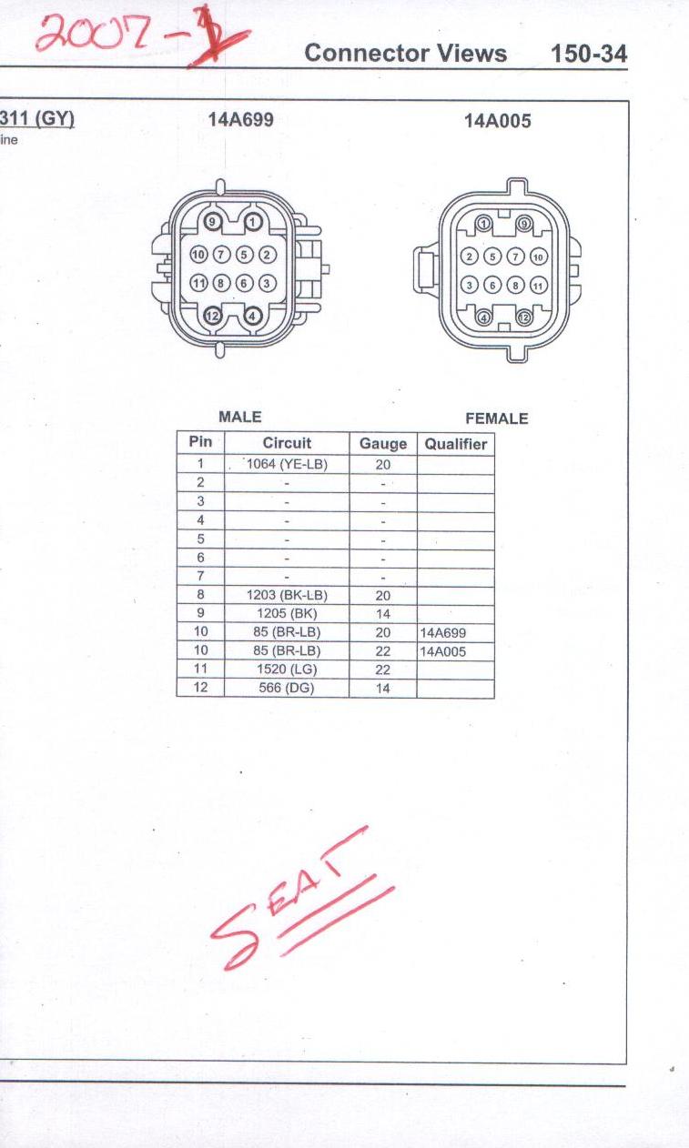

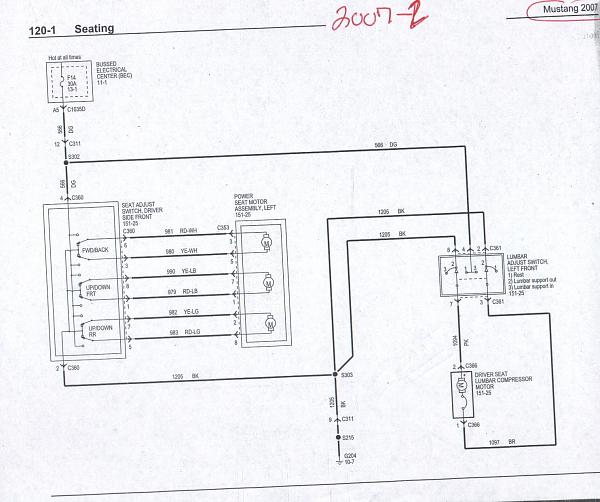

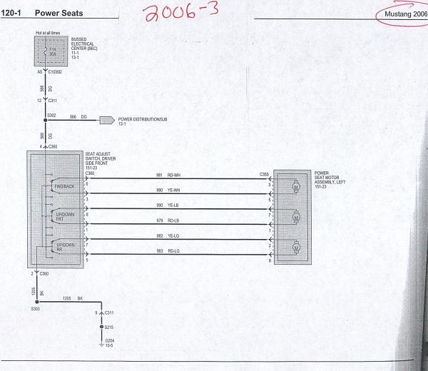

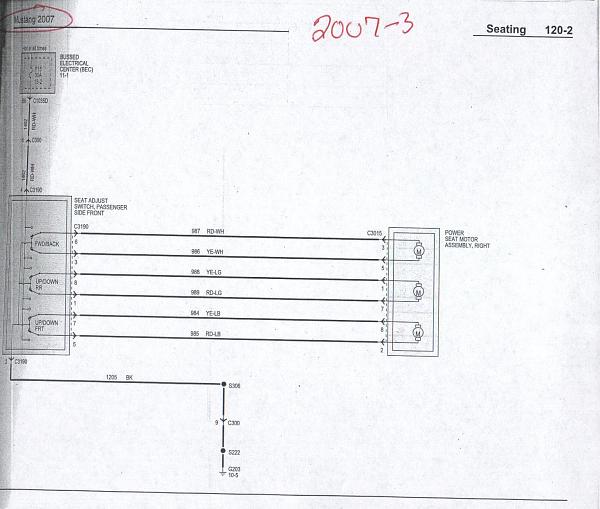

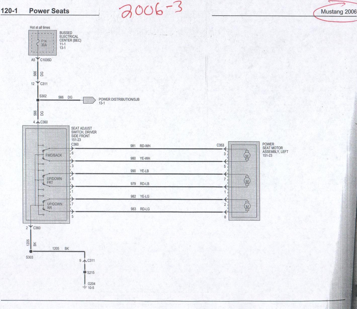

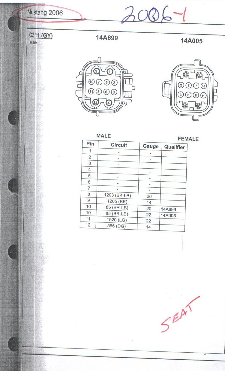

For Those who want to Know! Here are 05,06 & 07 Mustang Power & Heated Seat Wiring info.
UPDATED PDF FILES POST 7 05&07
KC 01/04/24
Enjoy!
KC

The Money Shot. The Diff Between Seat Harnesses
