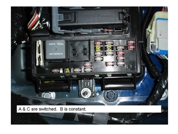

Where are you guys getting the Constant and Switched 12v for the control units?
Old Oct 10, 2010 | 11:50 AM
Scott2's Avatar
Joined: April 1, 2010
Posts: 841
From: King City, Ontario, Canada
Power is taken from the passenger’s side fuse box. “B” for constant power. Do not use “A” for switched power. The “Add-a-fuse” tap that that I was using did not work in “C” so I ended up using the fuse right below “C”. Hope this helps.

What is wrong with using A for switched power? I think I have mine there.
