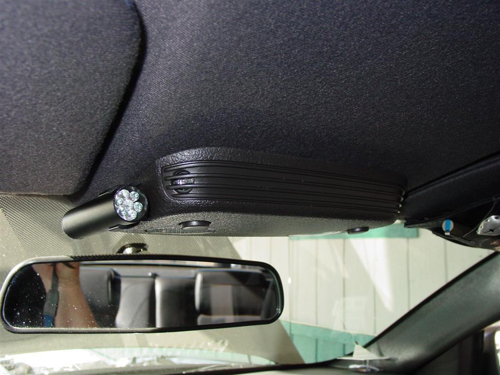

You are dead on the money Bill!! It is for the Raptor....You'll love it.
