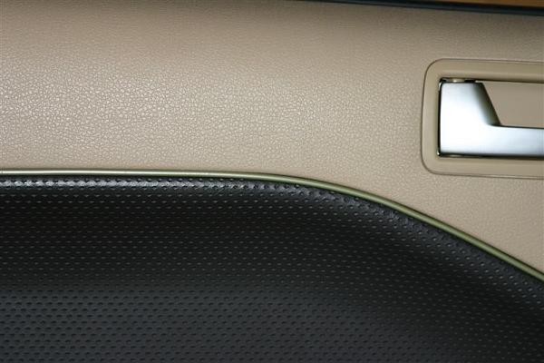

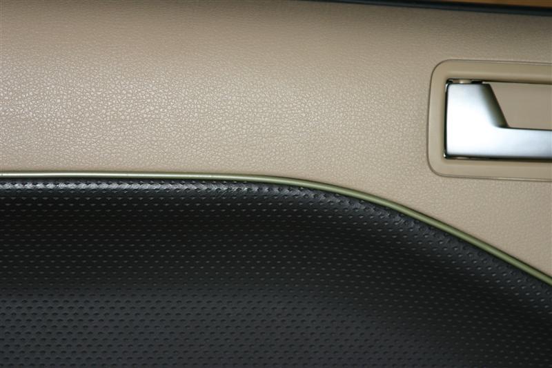

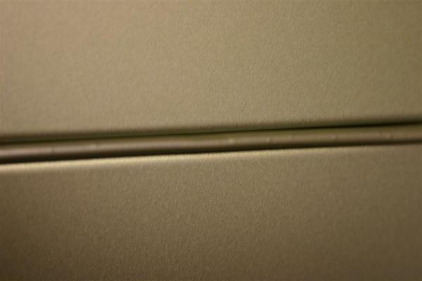

Legend Lime Piping
I have about 80 yards of LL piping/welting. The one I have matches the LL color perfectly. Pict's of a low light pict to show the color match up. If any one is interested, shoot me an e-mail, or PM

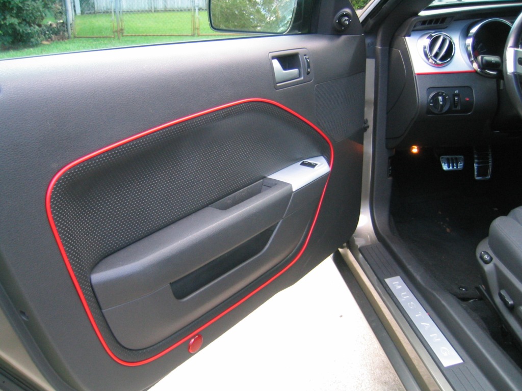

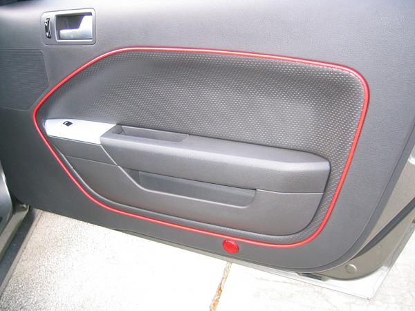

Red on Dark Charcoal Aberdeen
I went ahead with the red from YourAutoTrim. Bought about twice what I needed and it cost more to ship than the price of the welt – and the total price was only $15.94!!
I did the door panel seams and it worked well. I did have to trim the flange a bit on the bottom side of both doors as there wasn’t quite as much clearance there. I cautiously trimmed and simply butted the ends together just above the red reflector. It’s virtually impossible to see the joint unless you’re within about 6 inches of the door at that level!
I also experimented with the line across the dash but only was successful on the outer ends. The gaps were either too wide or too narrow in the center section and the area above the radio looked totally dorky with the welt inserted. So I settled for just the outside ends as shown below.
And I even experimented with the side panels in the rear seat area. That was not successful either, again, because the gaps are too wide. Installing the welt in that area looks very good and is very complimentary to the front but I’d have to glue it in place to keep it there and I just don’t want to do that right now!
Even my wife thought this was a nice addition to the trim!

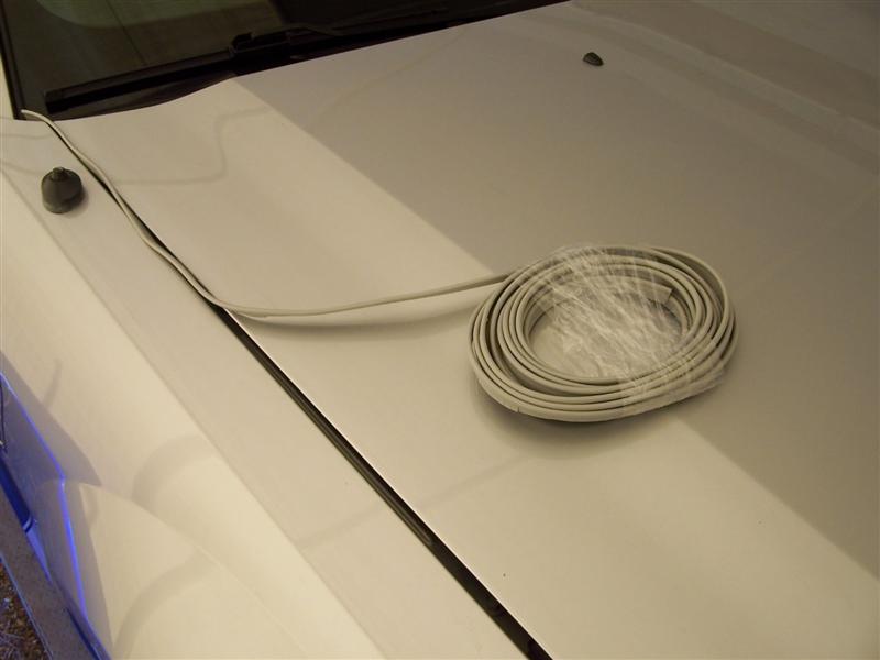

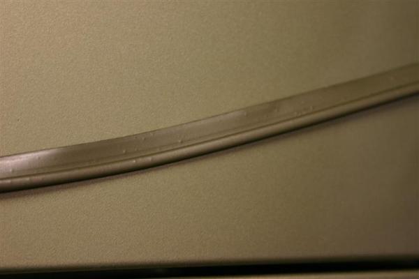

The Grey from YourAutoTrim is a little darker than Satin Silver but shouldn't
be noticeable installed on the inside Of the Door.
