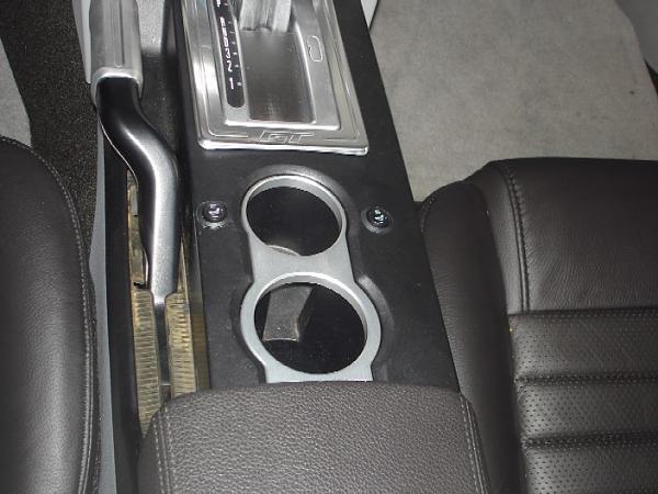

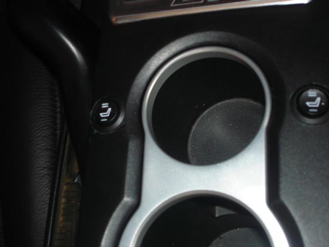

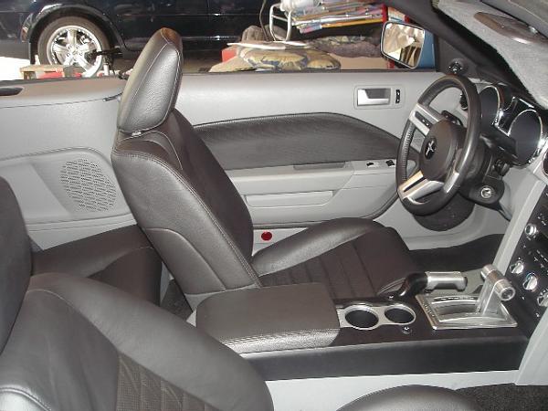

Pics and info
Some shots of the switches mounted on the console. I did not want toput them on the sides of the seats, not much room and a bunch of wires already there from the power seat, lumbar support and air bag stuff. Sorry for the blurry shot of the connector I tapped into, but it is located on the passenger side, about right knee high, on bottom of heater box. I pulled the connector apart and tapped into the female side (easiest access), utilizing the factory relay, as mentioned before. Used an eye ring connector to mount both ground wires to the shown factory ground point. All wires run from underneath the console, under passenger side carpet, up and behind glove box door. You can see one of the red fuse holders (there are 2), make sure you mark each fuse holder, identifying which belongs to driver and passenger seat. Again feel free to call (I'll pm my cell number to you) if you have any other questions. As for the drill bit used to cut out the switch holes, if you did not purchase it, I'll send you mine, and you can return it when finished.
I included a picture of the new leather interior as well, in case anyone wanted to see how the black looks in the LT grey interior.

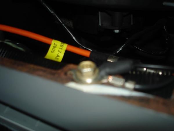

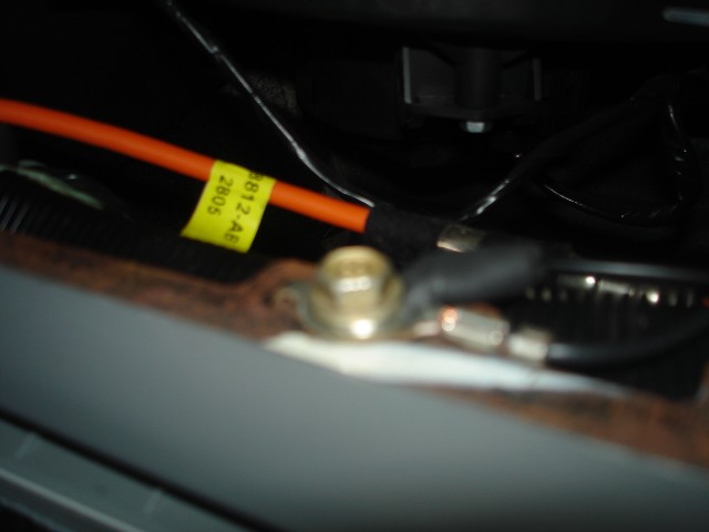

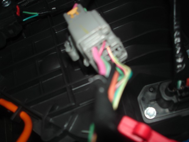

The tapped power source is the thick pink wire/wht stripe in the lower corner of the picture. Keep in mind that this is an upside down shot, so wire is actually located in top right pin slot.
