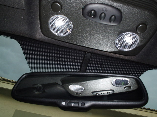

the extra plug is for the motion sensors, the Electrochromatic rearview mirror was not a option from the factory, Ford does sell a couple of accessory kits that you can purchase, I have one that I installed in my car,
it's the self dimming mirror with the compass, you can also get one that has the homelink in the mirror, I didn't need the homelink because I installed the homelink unit out of the visor that was in a Lincoln Town Car into the upper console in my car, the mirror is hardwired into the main harness running into the smart junction box in the right side kick panel.
