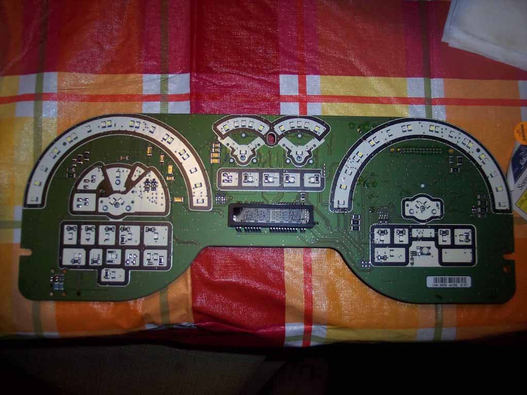

I researched this for quite some time, and found that the easiest solution was to swap the green leds on the dash cluster with the white ones, and vice versa. It took me a couple hours with a soldering iron, but it worked, and I am digging it!
Why ford did not leave them white at night i don't know...they are still dimmable btw but not overly bright at night in my opinion.

What type of soldering iron do you need? Seems like a *very* small and precise tip would be necessary?
Also, how many LED's are there? I want it to be white during the day and at night--seems like more LED's would need to be added. Are they a common size we can order?
I'm still hoping for a simple wire splice to do the trick. Once I have a little more free weekend time, I may pull the console apart and figure out which wires are involved. It seems like there has got to be a wire that fires up the white and a different wire that fires upt he green (either on the actual board, or in the SJB).

I did it with a variable iron, but a 12 watt iron would be fine. they are SMT or surface mount leds. basically an led with four small legs that bend around the bottom of the led. i first desoldered each one by holding the led with a needlenose and applying slight pulling pressure and applying heat to two legs on one sideuntil they came free, and then doing the same with the other side. im sure you could remove an led and take it to an electronics store to order some more whites. flux is a must when re-installing the leds to insure a clean bond. I don't have an o-scope to analyze the board with, but i can tell you it is not as simple as just a wire. I am sure that it would come down to jumpering a trace on the board to activate the circuit of choice (green, or white) but without a scope or schematic i opted to swap the leds. it was pretty painless. I will attech a pic of the board so you can see what you are dealing with though.. the leds with the yellow color are the whites.

Thanks for the pic. Now I see what you mean. If the white LED's are readily available, I may have to try swapping all the greens for whites. Based on your description and picture, I think if there is a simpler solution that takes just a wire splice, it will be somewhere in the smart junction box.
Or maybe the aftermarket will step in...

I am sure there is a simlper way, but I dont have the resources to find it. the solder job was not bad at all, just a bit tedious.

Here is the Manual information on the SJB illumination control. I've also heard of people mapping the CAN traffic with OBDII devices so there may be an easier way to do this mod without LED mods or the Mycolor upgrade.
