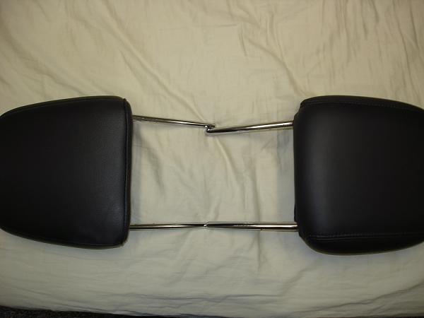

I don't have a Fusion, but I do have a 2008 MKZ. I'm assuming they take the same headrest, but I really don't know. In any case, here's the comparison between the two headrests...it won't work.
EDIT: I forgot you wanted dimensions. The poles are 0.5055" diameter, 6.1295" apart, 6.4620" from bottom of pole to top (locking flush to seat) notch, 1.5610" from top notch to second notch, 0.8205" from second notch to third (final) notch. All measurements taken using a digital micrometer.

Thanks - that's what I needed to know.
