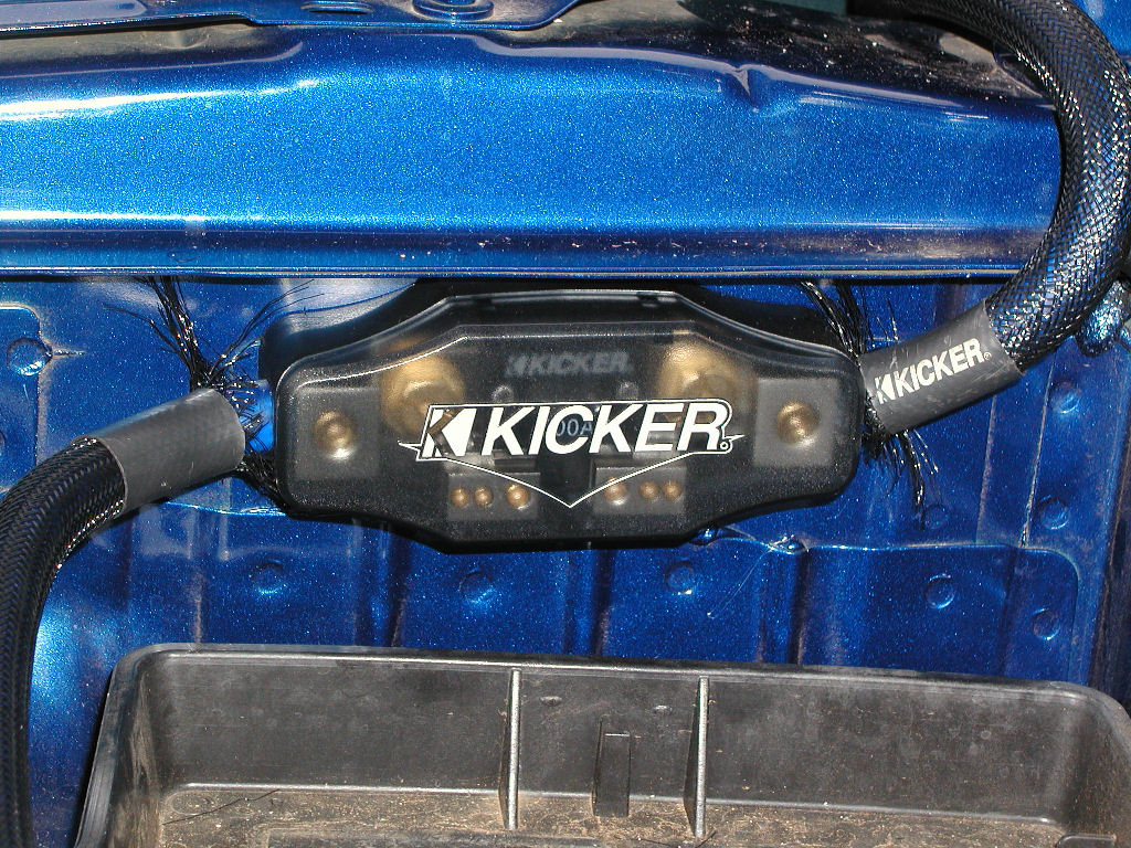

I ran my power line for my subs last night and I got to the part of installing the Fuse Holder.
I studied the possible areas, trying to maintain the recommended =/< 18" distance from the battery to the fuse holder but yet keeping it out of the way of everyday functions.
The only place I came up with is attaching it to the passenger side fender wall just to the passenger side of the battery. I haven't done it yet as I didn't have the right size SS screws, but I think it will work.
Does anyone have a better spot or pictures of where you attached yours???
I will post a picture of where I am talking about later today when I get to the camera.

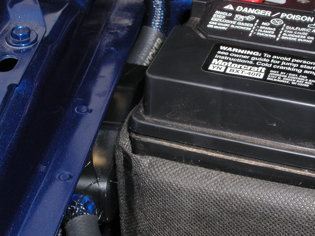

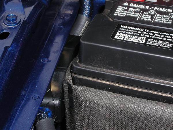

I went ahead and put it where I had planned. Anyone else do anything different ??
