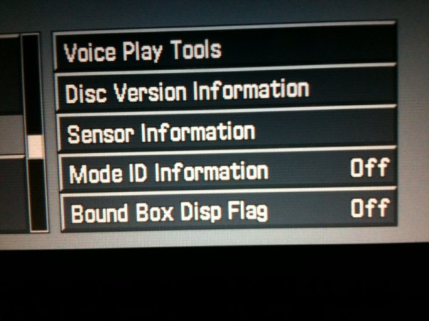

Something cool - once you do the above instructions:

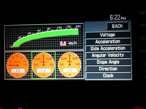

Scroll down through the special options, toward the end and press the sensor mode info button
Then it will bring up this screen. Touch any of the round dials, and you can select their function from the buttons on right. On my '08 Mustang the clock, speed, direction indicator, angular velocity (turn rate) and side acceleration (g-load) all work and make a cool display while moving. I like to keep the clock, compass, and g-load dials up and see how hard I am cornering.
If anyone sees other cool stuff in this menu, let us know!

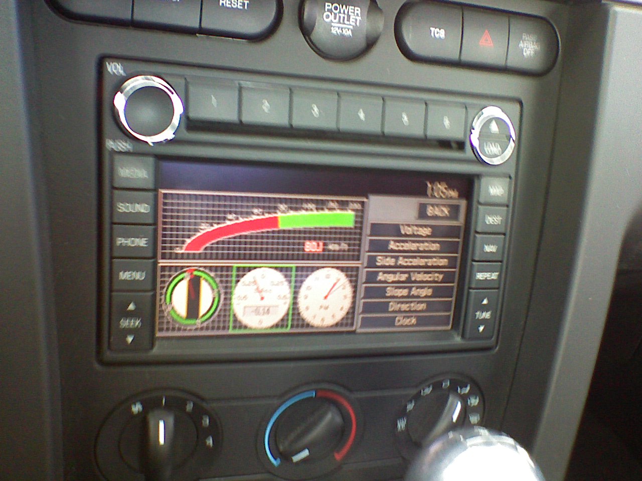

Right, the nav that was the factory option on these cars. Having the ability to kill the speed restriction while underway is great, and getting access to this virtual panel is cool! A mod that costs nothing. Photo is a quickly grabbed shot while underway.
=Vic=
