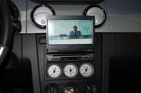

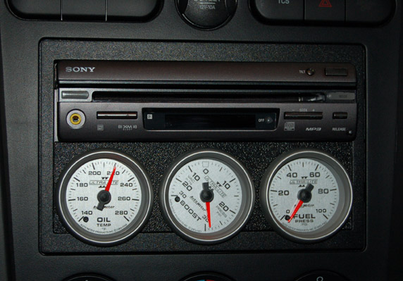

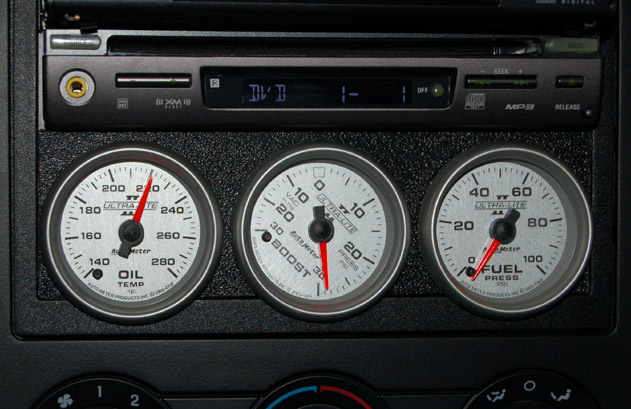

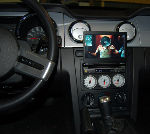

gauges installed
thanks, super helpful...
Here are some pics of the gauges, got them (and the stereo) in this weekend.. Let me know what you think.
I was missing some adapters to hook up the sending units on the gauges, so that's why the readings look a little odd, still waiting for those parts to come. Also, the boost gauge is clocked with the zero at the top not because i wanted to mimic nascar dashes, but because i had the gauges so close together that the mounting brackets wouldn't fit if they were all in line.
Looks good - I thought about doing that same thing because I have a pocket below my Eclipse deck, but decided to go with a SOS pod instead.
