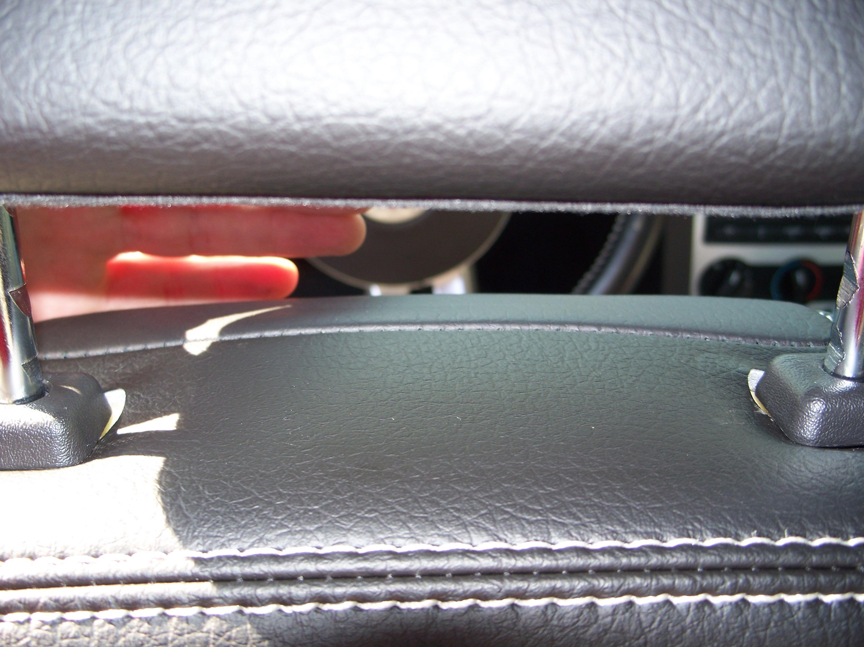

There is a very, very slight variation in the headrest holes but absolutely nothing objectionable to me. I always leave the headrests down anyway. I suppose the slight variation could be hidden with some softside velcro to mask it. For $295 I cannot complain...
Do you have a picture of the variation here? I'm close to pulling the trigger on this one.
Old Dec 23, 2009 | 07:49 AM
Dineau's Avatar
Joined: May 13, 2005
Posts: 574
From: Laval, Quebec
Yes, a picture would be appreciated as I'm also considering changing them...
Thanks
Old Dec 23, 2009 | 10:23 PM
watchdevil's Avatar
Joined: February 5, 2008
Posts: 2,339
From: Chattanooga
I just caught this reply, so let me take a picture tomorrow or the next day. Trust me it's worth pulling the trigger on. I could not be happier! You can always do something to mask the variation. I leave my headrest down anyway so it doesn't bother me.

Here is the pic... like I said it's not much to worry about. The headreats are down all the time anyway. I suppose could go in later and mask it with the soft side of black velcro.
yup...exactly how mine look
