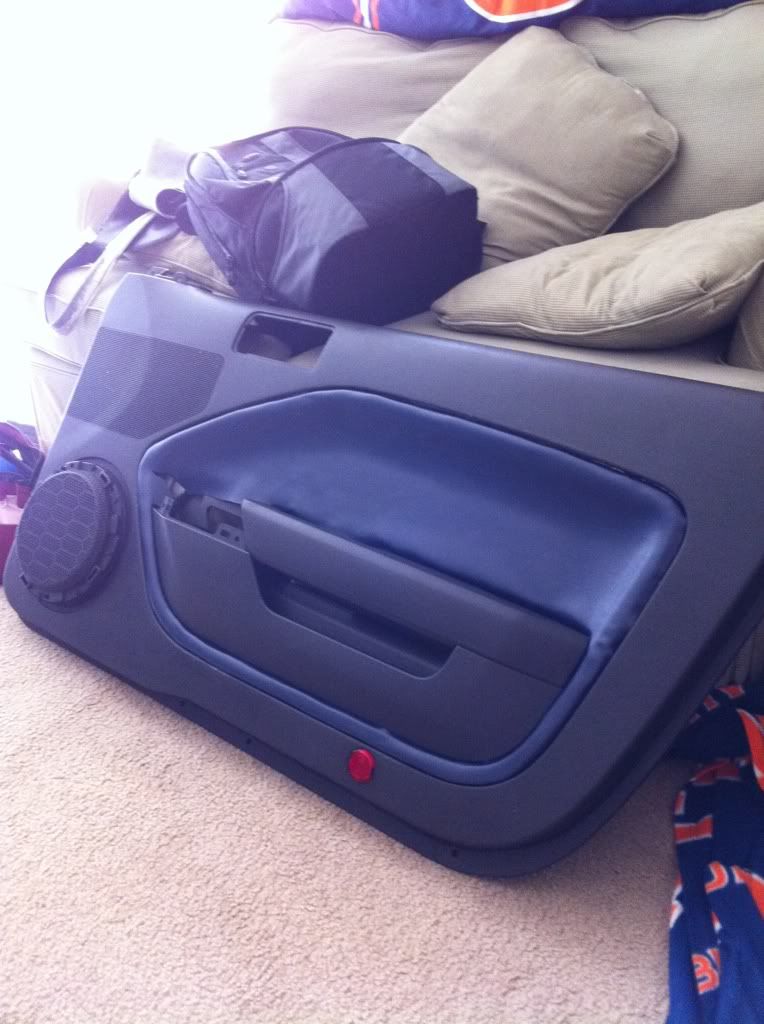

just do them yourself?? i did mine blue last night. first time ever attempting something like it..
remove old insert, scrape off glue and padding, add new padding (i went with memory foam, so comfy) and then add new material. i used marine vinyl, all my products used were bought at jo anns.
they have whites also, many shades.
