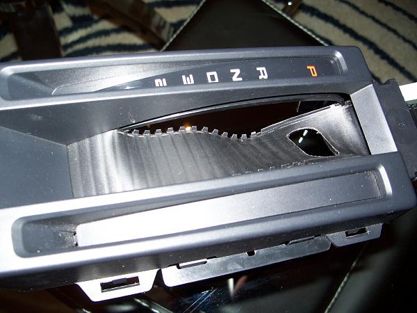

I didn't see anyone respond to this thread. I have an 07 and the rubber/plastic slider self distracted. Ford says can't fix. Need to replace whole shifter.

Are you referring to the rubber sliding part in front of the shifter coming loose? My car has this problem and was wondering if it could be fixed or not. I need to take the console apart to see what it looks like.

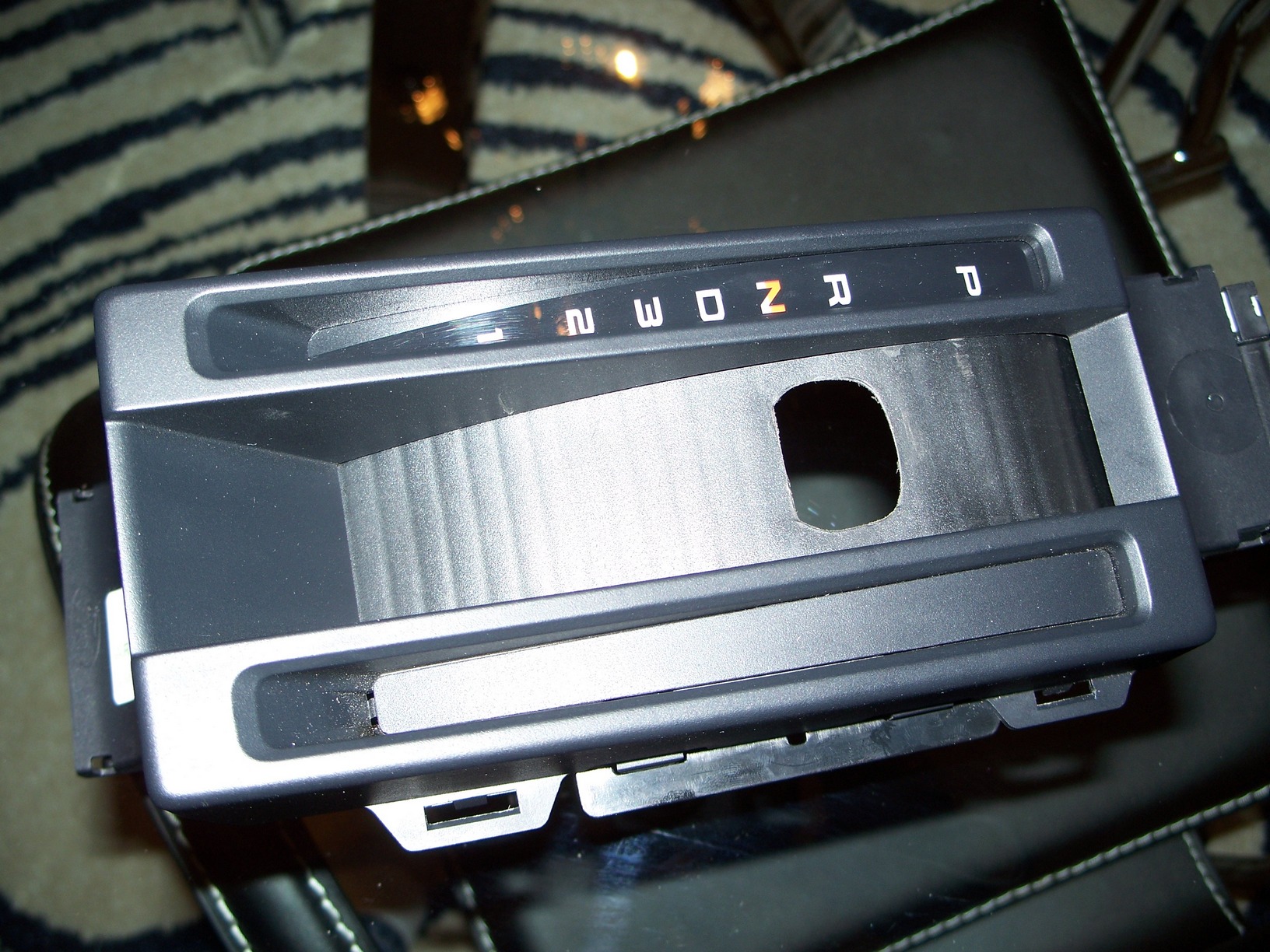

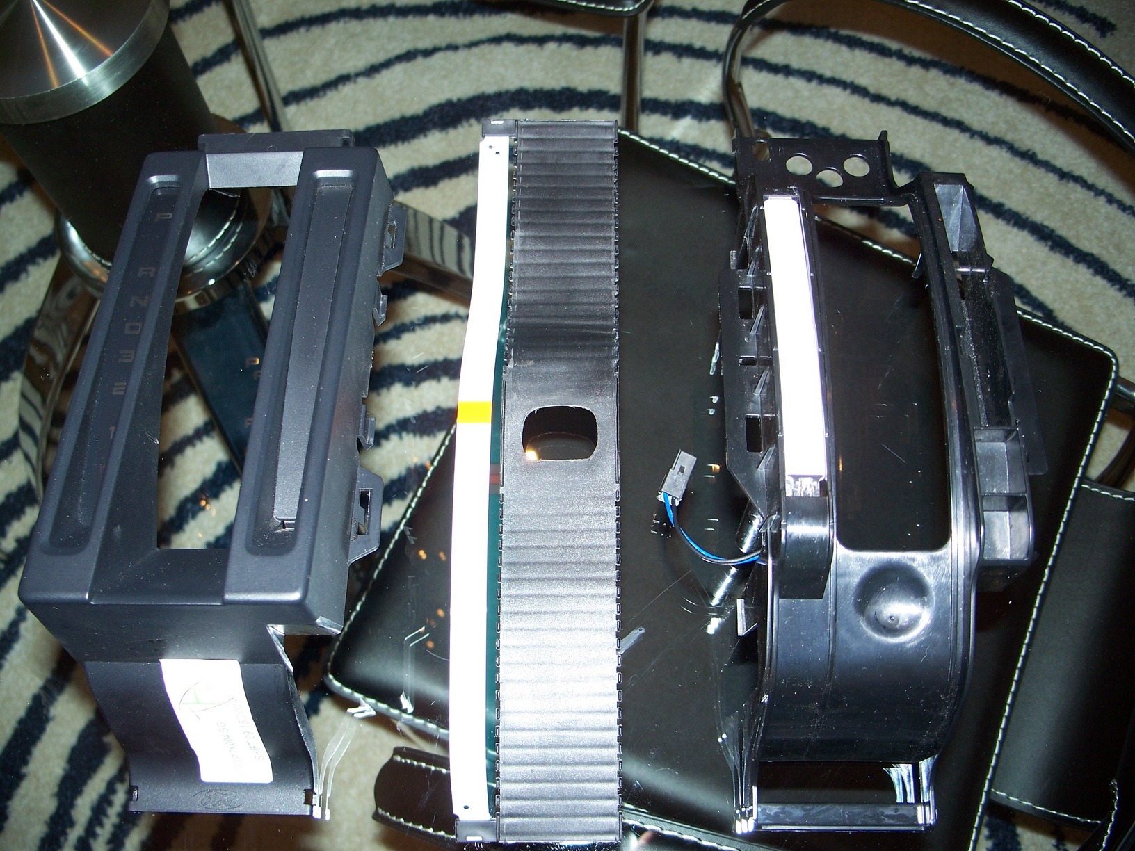

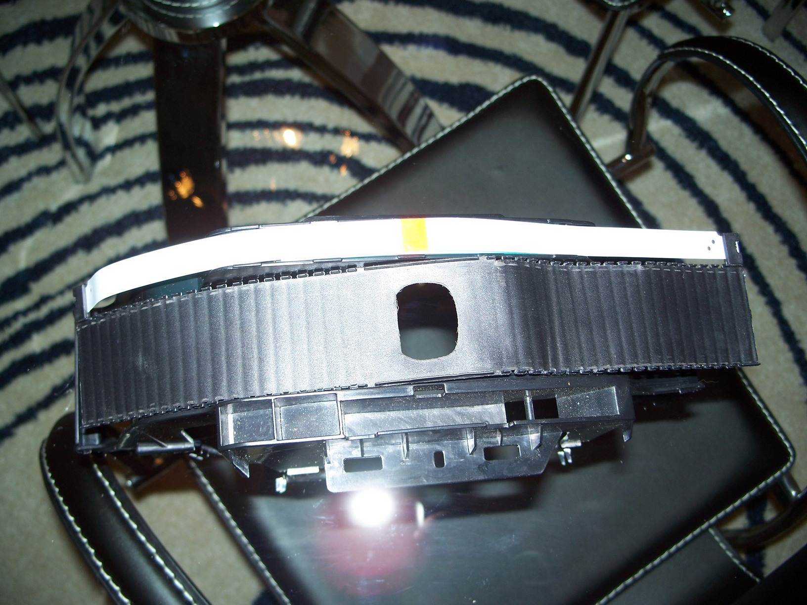

This can be fixed. Just remove the console. The shifter indicator bezel just snaps out of the shifter base. Once removed the whole assembly snaps apart into two halves. You can then reset the sliding blind back into the grooves they slide in and snap the whole thing back together.
Baloney! Read the post above. It usually just comes out of the track and needs to be taken apart and reset. It all snaps together and easily comes apart. If the sliding blind is actually torn then consider replacing it with a boot that sits within the slide area or find a blind in a salvage car.
Although this is a 2010-12 style bezel, the 2005-09 assembles exactly the same.

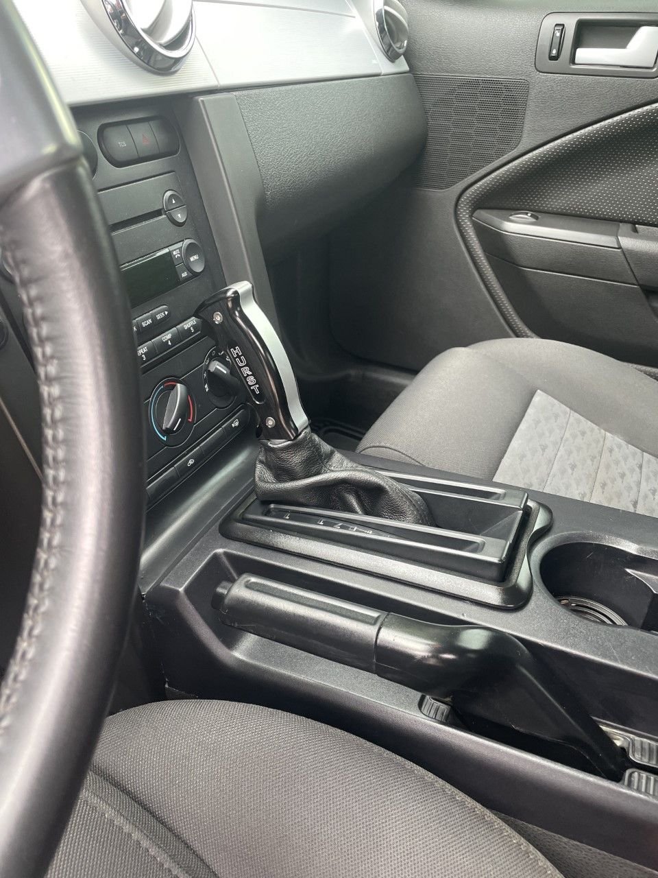

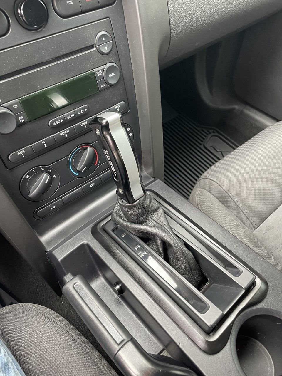

2010 Automatic Shifter Installed in a 2005-2009 Mustang
I did not like the looks of the 2005-2009 automatic transmission shifter, so I took the idea of one of the members here and modified and installed a 2010 shifter in my 2006 mustang. $70 for the used 2010 junk yard shifter, $35 for the leather boot, and $265 for the Hurst shifter handle. The center console and the top center console had to be trimmed for fitment, and I used a 3 inch drum sander to contour the shifter bezel to clear the cup holder. The Hurst shifter came with a new remote mount Overdrive On/Off button, and I mounted that on the side of the top center console cover. The only downside to using the leather boot is that there is no longer a PRNDL indicator, but that doesn't bother me. If someone is on a budget, the swap from a 2005-2009 shifter to a 2010 shifter would be pretty cheap to do by just using the factory 2010 shift **** and trimming the center console.
