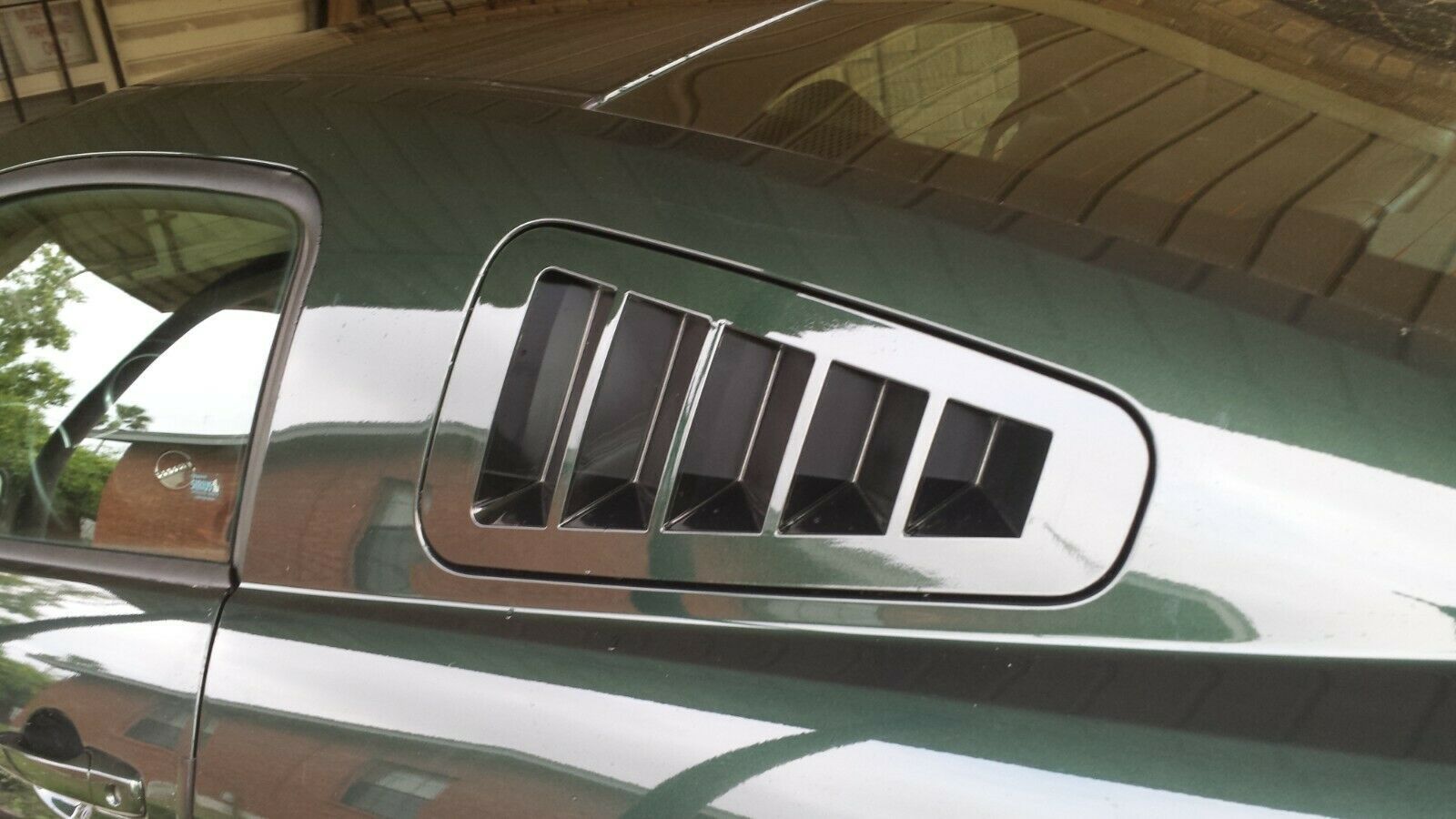

If you don't want to attach with 2 sided body tape nor mess with any drilling, SilverHorse Racing flush louvers are your only other option. Here's the links and image provided below, if interested. Just be aware if your installation skill levels are limited? You may want to consider having a body shop install them for you professionally.

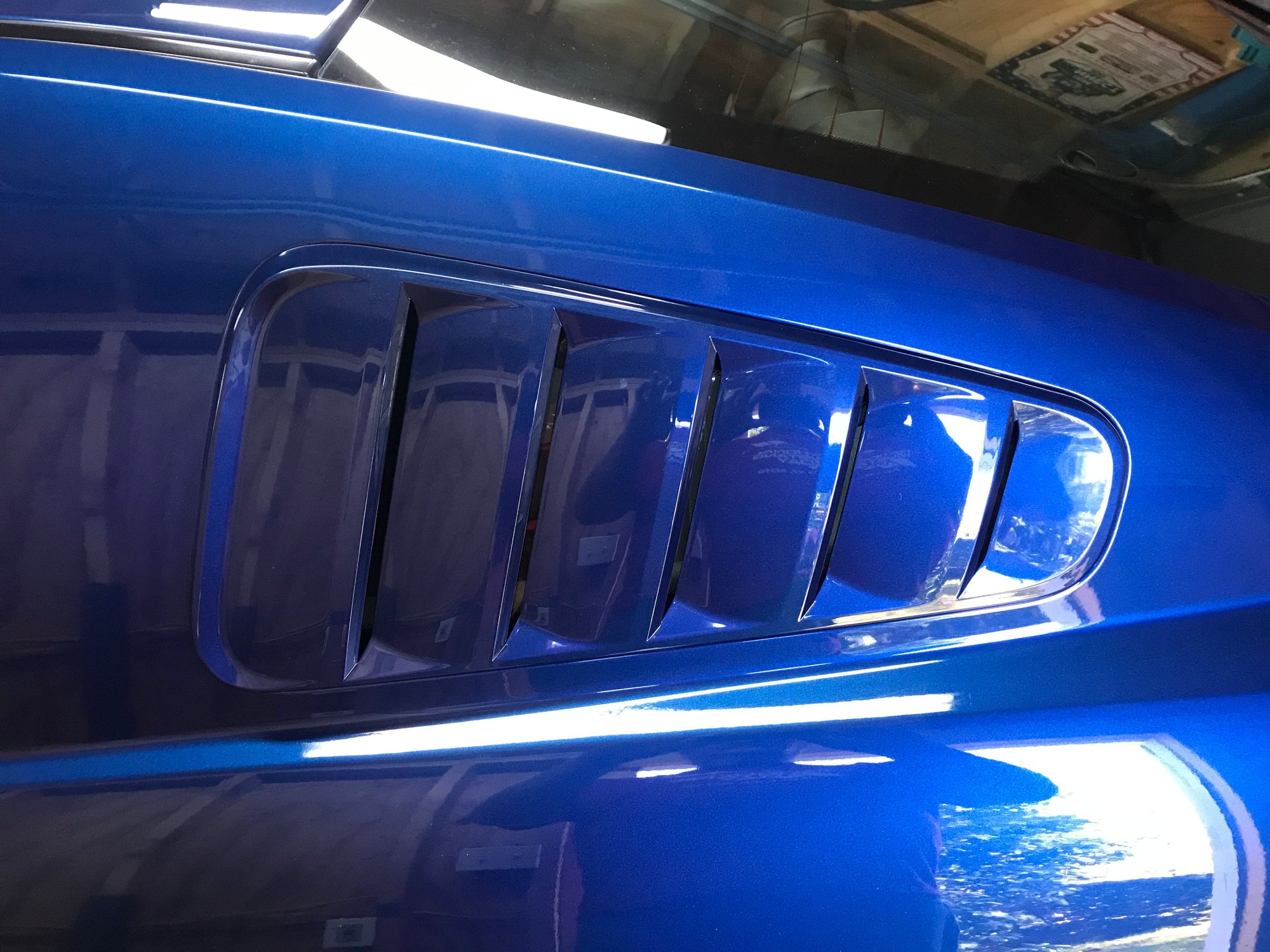

I had a mobile glass guy install mine on Thursday. it is almost like looking through the glass from the inside. A little distorted because it is Lexan and at an angle. These are a very nice addition.
Had these on for about 5 years.

Just to clarify, there is no painting around the quarter panel windows with the SilverHorse Racing louvers whatsoever. The reason, the quarter panel glass is completely removed and replaced with the SilverHorse Racing louvers. Therefore there are no areas around the windows that require painting. You can also call SilverHorse Racing with any questions/concerns that you may have about their louvers.
