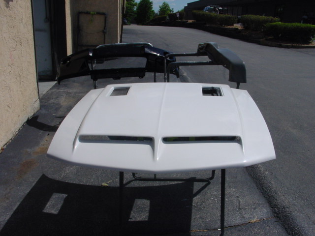

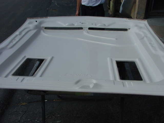

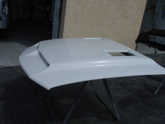

I have one getting painted now should be back in a week or so.

Very cool. Is it fully functional? Do the vents "vent"?

Yes and no,,,, the front vents are open and Cervinis has an optional ram air kit, you can see the frame lines of it on the underside of the hood photo. the extractors are set up to work but also come with a drip tray to divert water away from the engine and drop it between the engine and the wheel well. The problem is the hole for the water to come out of is about 2 square inches, that is the same area the heat is extracted from.
I plan on taking a grinder wheel and cutting a series of slots around it for the heat to release from the engine. How much heat can be extracted from four or five 1/4 by 4" slots? not much, but more than Cervinis has set up now.
I guess you could go with out the drip trays if yours in not a DD, but mine is and would like to keep the extra water from dripping on the engine.
