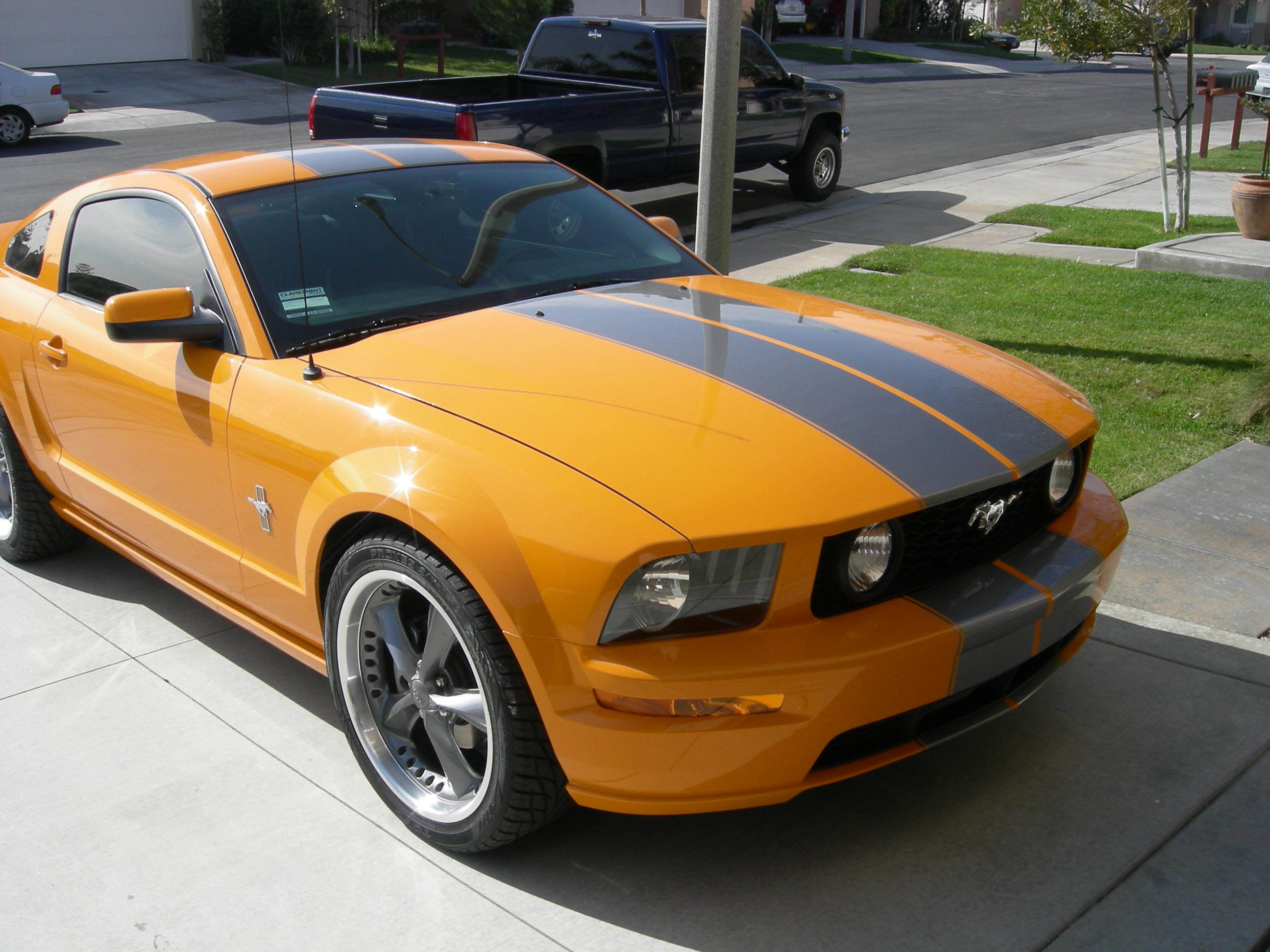

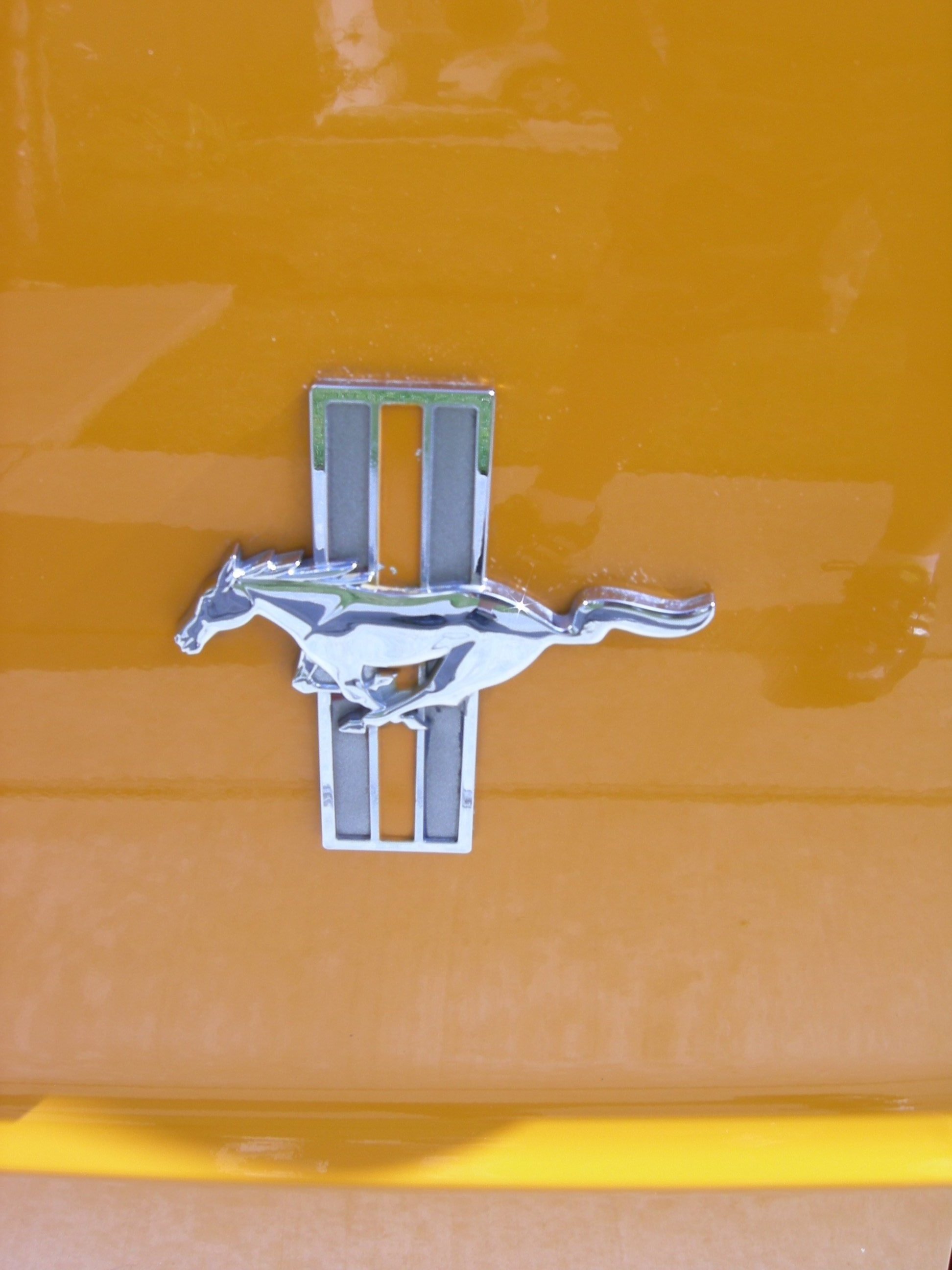

Originally Posted by ryan1112
My vinyl is showing a lot of wear from road chips so next month I am having them painted on. I have been quoted $1300 from Interstate Ford. They remove the bumpers, scuff the entire panels, paint the stripes then clear twice. Does that seem like a reasonable price for that?
I have looked around and I don't know where else to get quotes from. I have had paint work from this dealership done before and they do great work and they have great customer service so I will most most likely go there but I would like to get a couple quotes. Does anyone know of a good paint shop near Dayton Ohio?
Ya $1300 is good from a dealer. The cheepest I have seen is $700 thats what I paid
here in So.Cal.

I can't believe that you found a place to do it for $700. Great deal. Did they clear the entire panels?
Yep the same shop did Rebel73 stripes here in So.Cal. they do great work and are
very fast. Sanded down all the panels,painted the stripes and re cleared all the panels
and then rebuffed the paint after 30 days when the paint is set.

That is definitely the best deal I have ever heard of on getting stripes done. Were the body panels removed from the car before being painted?
