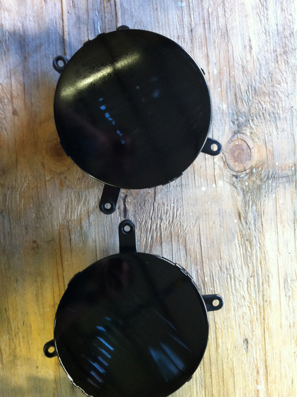

Well here's what I got... I came home tonight determined to get this project close to being done and I just have to let it cure tomorrow. And it's hot enough here that tomorrow they'll be done.
Overall... I'm very very happy with this project. VHT and the clear were super easy to use and the final product will be sooo good. I might do a little tint on the headlights and taillights now. Just to give them a little shade and make the tails a little darker cherry. Thanks again wade. I'm confident now and this was easy and didn't take long. What a good mod.

1) One fog sanded, one not. 2000 grit

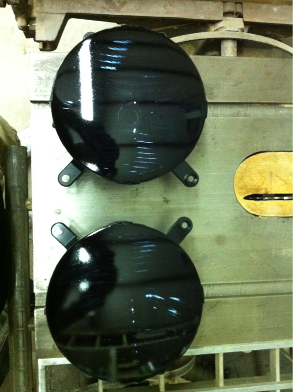

2) both sanded and now with a coat of VHT on
3) second coat of VHT
4) I sanded once more with 2000 and then sprayed three coats of clear. It's that shiny and pretty smooth without even wet sanding! So great
