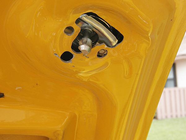

Here's mine I had a local shop install in my RK Sport hood about 5 years ago before anyone had a hood for them. I got them from Mustangs Unlimited and they're for a 71 Mach 1 ...

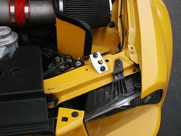

Ok....so bear with me here...I literally cut this out of paper to help describe what this guy did. It is far from perfect, but should get the point across. Hopefully, at some point in the near future, I will get ahold of the original pics he took and can post them...till then, this is about as good as it gets.
First, he went to Lowes or somewhere like that and got some decent thickness stock metal. You will need one piece maybe 8" long or so (to be cut into two seperate 4"-5" long pieces). He rounded off the edges to make it look nicer, but it isnt necessary. Basically, this is what it would look like size and shape wise:
While there he also bought some sort of metal tube that was slightly larger diameter round than the actual hood pin. I would take one of them with me and using it as a guide, help determine the size you would need. You obviously wouldnt want something significantly larger, but I wouldnt do anything extremely tight as it will prove difficult to use when its actually installed. You will need to get a piece long enough that it could be cut into two 2"-4" lengths (the length will actually depend on the pin depth as well as the hood fit so I'd definately get too much than have too little and them end up 'short') as 'seen' below:
Now, he took the second piece and then welded it to the first so it would look something like this:
Now, he cleaned up the weld (I think this is actually when he grinded down the edges of the flat piece and rounded them off) and then drilled the two holes in each bracket for the appropriate sized bolts he planned on using to attach it to the car.
Now....thre are two other things needed to do to the rounded piece. Both are important.
First, he needed to drill into the side of the tube all the way through so a wire could be placed from one side to the other so the hood pins have something to grab hold of. To do this though, he had to do some planning in ADVANCE PRIOR TO DRILLING. Determining just how far up or down on the rounded piece to drill for the wire is going to need to be figured out...I'm not sure if he just guessed or had some way of measuring, but he only drilled once for the hole (by his pictures that are now missing on his thread). If I cant figure it out the first time I drill through, I'll just add a second set of holes either above or below (whatever fixes my pins....if they hook up and lock and still sit too high, I'm going to drill a set of holes LOWER than the first time....if its too low and I cant get the pins to grab the wire, I'll drill another set of holes higher up this time) till the hood pins are in a preferred final locked in position heightwise.
Secondly, and JUST as important about the 'height' of the hole you are going to drill is the location...What I mean is this. If you want your pins (on the top of the hood with the hood closed) to be in a certain 'position' this is where you need to determine the direction you want them to face. For instance, here are the pins I am using on mine:
If, when in the locked position, you want the tops of the pins to be 'parallel' to the fender/hood gap, then you will need to figure out in advance how to position the wire. So even though when you first push down on the pins to start locking them, they might not even closely line up to the fender, but when you finish turning them to the final 'locked' position they are in the position you want for a final 'look'. It might require you to drill through at a 12 and 6 oclock position, or it may require you to do a 2 and 8 position, its all going to end up being your preference. If you dont care, then drill them where-ever, but I would suggest doing both the same so at least you dont have two different lock positions. The 'wire' he used to put through the tube was literally a rivet. He had taken a picture of it pushed through but he hadnt cut the top of the rivet off yet. Point is, you can pretty much use anything, but you'd better make sure its strong enough to handle something grabbing on to it tightly and not breaking over time (whatever I use, I wont weld any part of the 'wire' in place. I will run it long through the hole and 'bend the ends down. This way, WHEN it eventually breaks from wear, I can just slide another one in, bend the new ends down, and then close the hood and attach the pins). Here is a basic picture of what I'm trying to say:
Ok...now one other thing. If you look close at the top of the 'rounded' piece, I actually cut it and bended the edges out slightly. The guy that came up with this (his name is pascal on another site and he is a professional body guy/painter) said if he ever made another set of these he would ream out the top slightly so its easier to locate the hood pins into the shaft to get it locked into position. I will definately do this.
Now your done. He cleaned them all up and painted them black to blend in with the car. He attached them on the top of the radiator bracket with their exact locations being determined by the pins/hood location when the hood was lowered into place. Obviously, every hood is slightly different so there is no 'absolute' spot. I know my hood seems slightly 'shorter' so I will put mine on the same radiator bracket, but I will have to cut into the 'boxed' part of the beam so I can slide the new bracket back a bit further so it can attach.

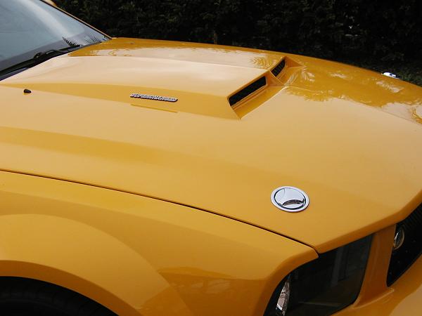

Here is a picture of my hood with the correct pins, BUT NOT THE BRACKET. I'm posting this to help show what I mean by deciding how you want the pins to line up. Mine do NOT line up with the fender/hood gap. When I do fab this bracket up, I will make sure to change the locking position so they do. If you look close you can see mine in locked position...and two different ones at that. One is around a 10/4 position and the other is 2/8. It would/will look much better if they match and (IMO) are parallel to the hood/fender gap:
I hope this helps. If I can ever get ahold of the actual pictures I'll post them up immediately. Sorry about the crudeness of the pics, but its about the only way I could think of explaining without it being totally confusing. Here is a link to the original thread....at least you can read his explaination (though the pics did most of the describing) and ask him if needed. He's extremely helpful and a really nice guy. http://mustangforums.com/forum/s197-...enom-hood.html

Wow you are awesome , good explanation , and really good mock ups . Afet I have seen them I am sure I can make them . To bad you dont live in Colorado , we could be making those and selling then . (lol) Could you hook me up with where you bought your hood pins , and once they are in the hood , what keeps them from falling out ? Stupid question I know , but i dont want them coming out after I open the hood .
