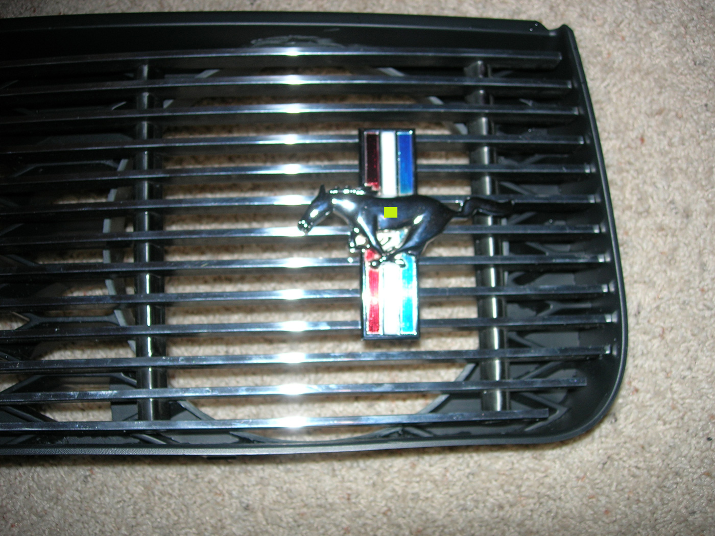

Could you get some close up pics of how you got the pony emblem on there for me to look at?

Sorry, I have a zillion pictures, but not one of the back of the emblem. I attached a close up of the emblem on the grill. In that location (three bars up from the bottom), all the mounting pins fit in between the bars and the emblem is straight.
I took a small stainless steel bolt and put the bolt head on the back side of the emblem where the yellow square is in the picture. The horse's body is recessed on the back. I filled that area with JB Weld and it secured the bolt to the emblem. I put some emblem mounting tape on the back of the emblem and bolted it to the grill. I hope this helps.
