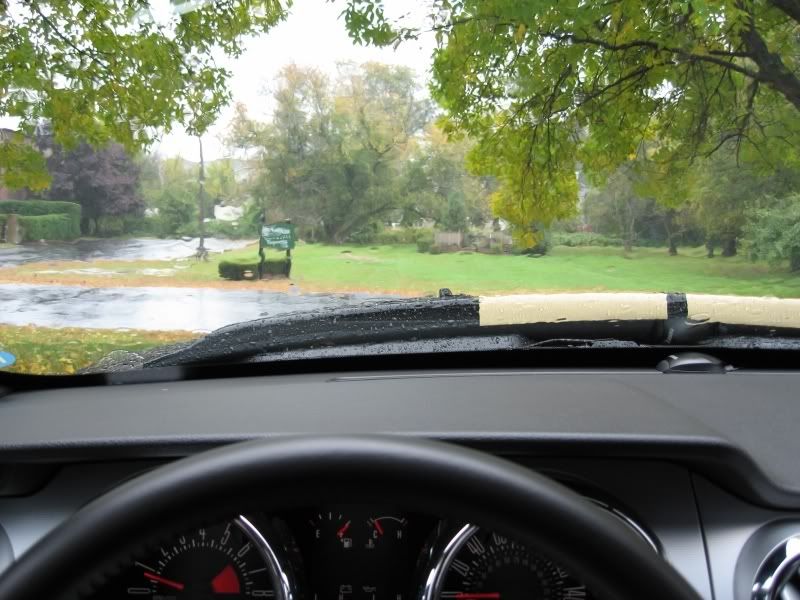

Old Dec 1, 2006 | 08:07 PM
Monolith's Avatar
Joined: October 9, 2006
Posts: 52
Here's a pic I posted before of the water issue, but it also shows the black plastic insert that I was indicating that could be cut out. The problem is, I don't know if it is too far forward to do much good for the engine. You might want to think about modifying the rear of the hood instead of the front lip.

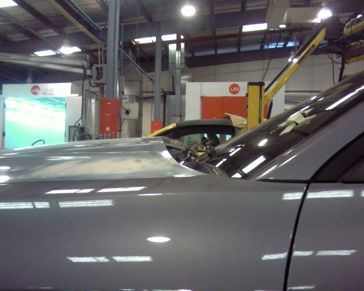

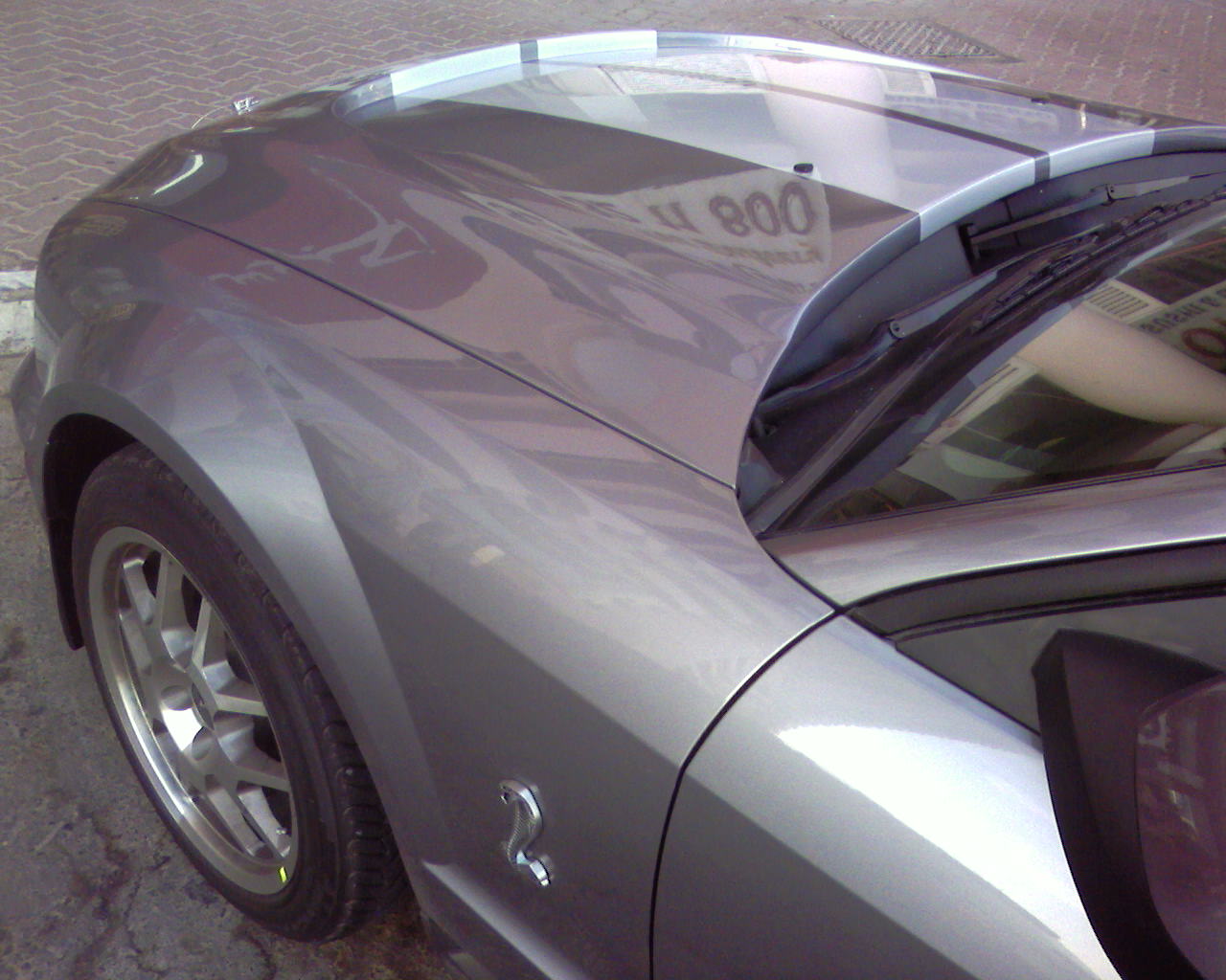

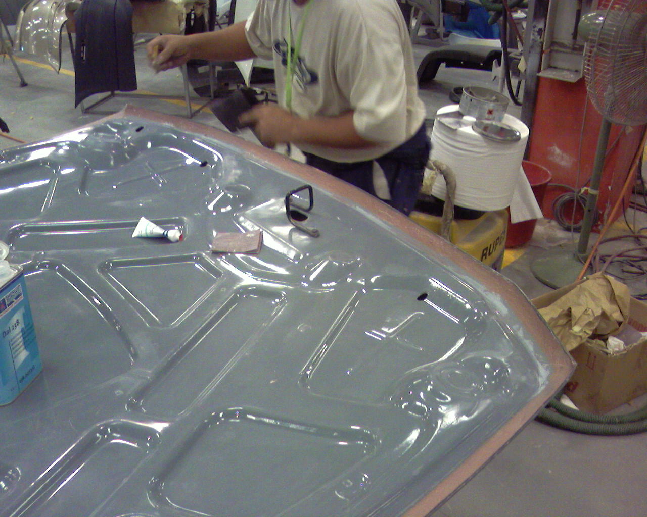

When the Shelby GT-H went to production, Ford specifically requested that the single layer fiberglass CS6 hood is to have another supporting layer added to the underside.
so shelby made a mold of the original hood and used that
as a result, making the hood functional is no longer that simple
even Shelby themselves told me i could cut open the grille area and make it functional and good looking, but the underside will take so much work to make it look right.
my hood needed a lot of prep work to get it right, as it arrived broken in two areas during shipping
and i re-inforced the edges where both fiberglass layers meet
i'll attach some pictures that show the high cowl end and other angles of the hood
check out the full job photo blog
and a video of the finished project to get a better idea on the fit of the hood
