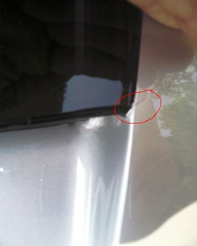

My RKSport Cali Dream hood is starting to crack on each side of the drivers side vent. Has anyone else had problems with their hood? Mine shakes pretty bad when going over 85. I have a feeling all that bumping around might be causing it.
I have the Ford Racing hood pins but never put them in. Now I'm not sure if I should bother if I need to get a new hood. I'm interested to see what you all think.

I sent the two pics below to RKSport and they got right back to me. They are going to look into the issue for me. I'm very impressed so far with how responsive they are.

That's my exact line of thinking. RKSport at first didn't want to honor the warranty and blamed it on the installation and hood struts. Problem is the hood is lines up fine, and the crack is not near the place you would expect. Either near the front of the hood where I close it or back by the struts.
Right now RKSport is evaluating my high res pictures I sent last night. Hopefully they will stand behind their product. My body shop looked at the hood and said it was really thin in those areas and air pressure probably cracked it. Regardless even if I got a new hood from RKSport it isn't going to be cheap to have the rough taken out of it and painted. This a great opertunity to show the Mustang community how well they stand behind their product. I hope they don't blow it.

Here are some better shots of one side of the crack.
I really just don't see how it's hood struts because of the location. Keep in mind it's doing the same thing on the other side of this vent. Just not as big yet.
