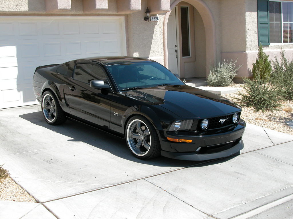

as far as i know they have fixed the offset problem with the razor wheels you might want to give american racing a call and see, someone just posted a pic of there black 05+ with 20 inch razor wheels and they have the correct offset

I haven't seen these advertised online with the correct offset, but obviously they make them...these pics sold me on the 20's.

thats the one i was talkin about
