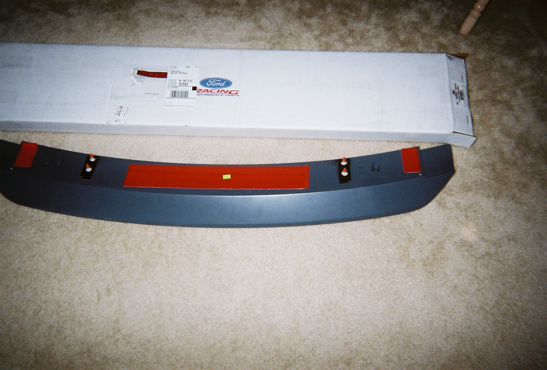

Can someone who has performed this project share with me a step by step process on how to remove my factory spoiler without damaging my decklid? I have heard many different ways. I have my new spoiler painted and ready. Thanks!

get some blue painters tape to start with ,then a flat pease of soft plastic to work under the stock deck spoiler ,,and just go slow pushing under the stock spoiler mounts ,it as double sided tape ,,once you remove the bolts,the two on each side under the deck ,,put the painters tape on each side of the stock mounts before you start so you don't damage the paint on the deck ,this all takes time ,,go slow ,,one side at a time ,,,good luck that stock stock spoiler is a pain in the butt to get off ,,with the double sided tape holding it on ,,Ford has good tape .

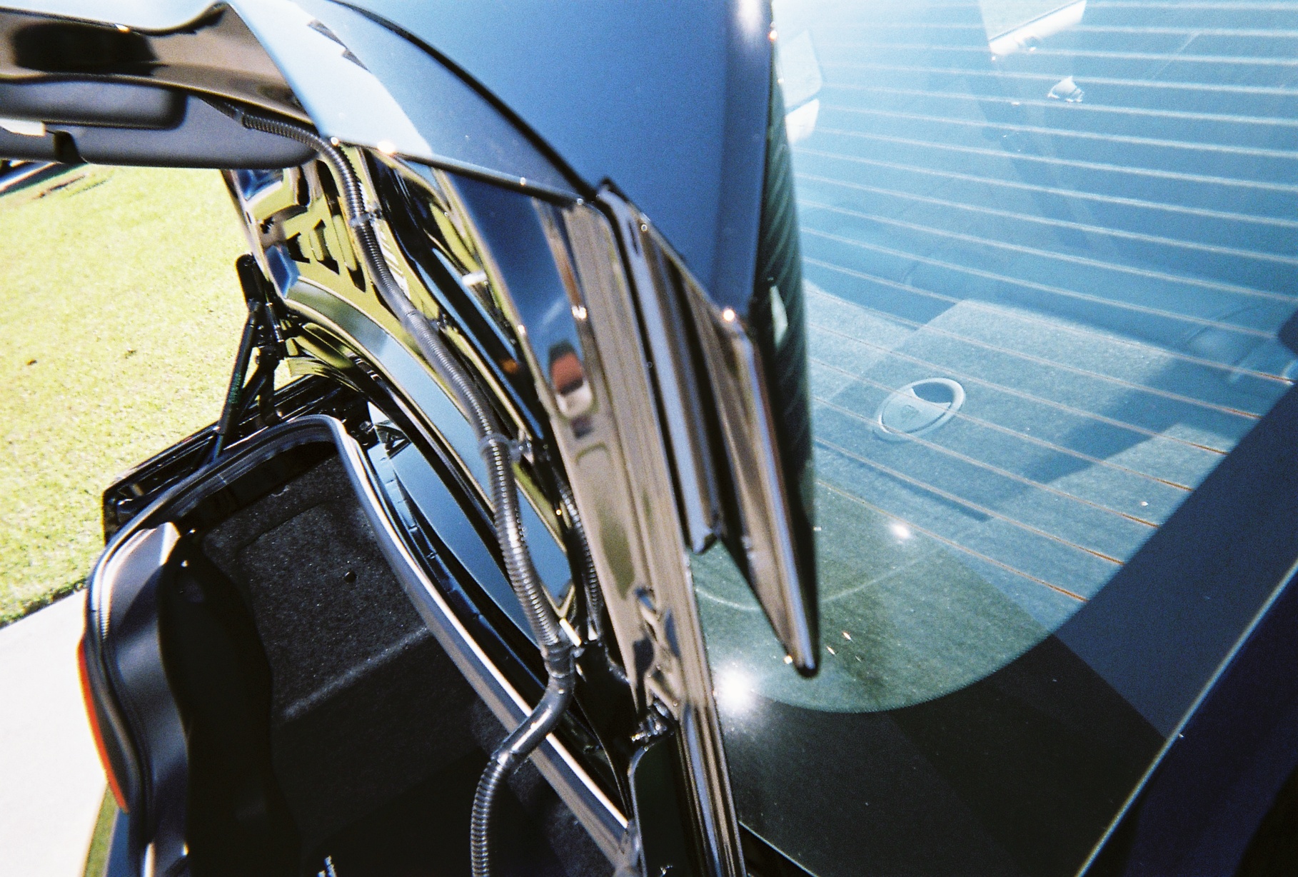

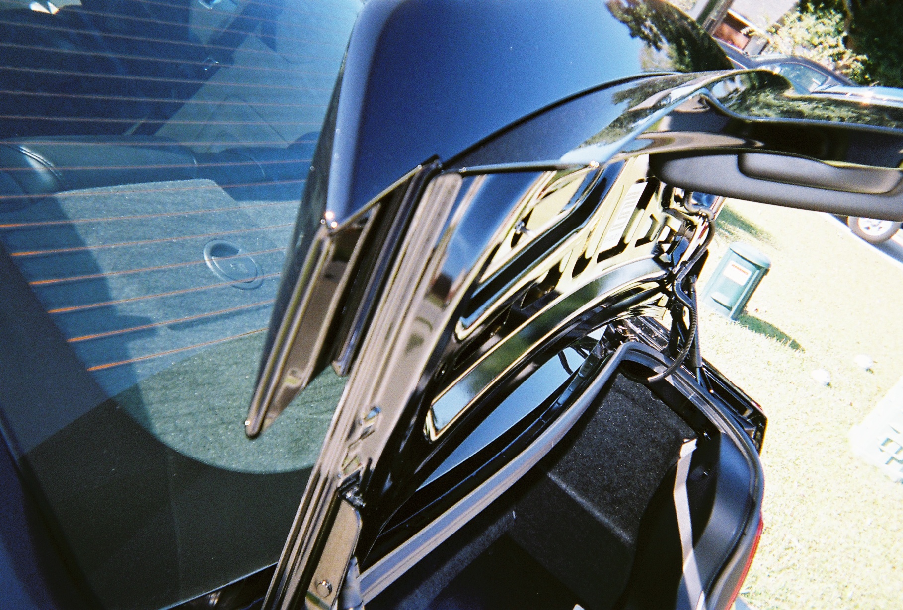

thanks for the information, your help will really assist me, believe me I will follow your advise and take it slowly. By the way, I did not think to order my spoiler through the Ford Racing Catalog, I ordered my through my Parts Dept. as a service part, it looked the exact same as yours with double sided tape and plastic caps on the four studs..... Thanks for the welcome note. Your car looks awsome!

I've done this twice. I would advise against using any plastic device/scraper for fear of marking up the clearcoat. Just use the painter's tape, then use 40 lb test braided fishing line in a sawing motion to cut through the double sided tape on the original spoiler. After it's removed, just clean off the residual tape with your finger, then use Goo Gone, if needed. I had to drill the needed 4 holes on my Shelby GT, as it didn't originally have a spoiler. Your pony already has the needed holes. Here's some photos of mine.
