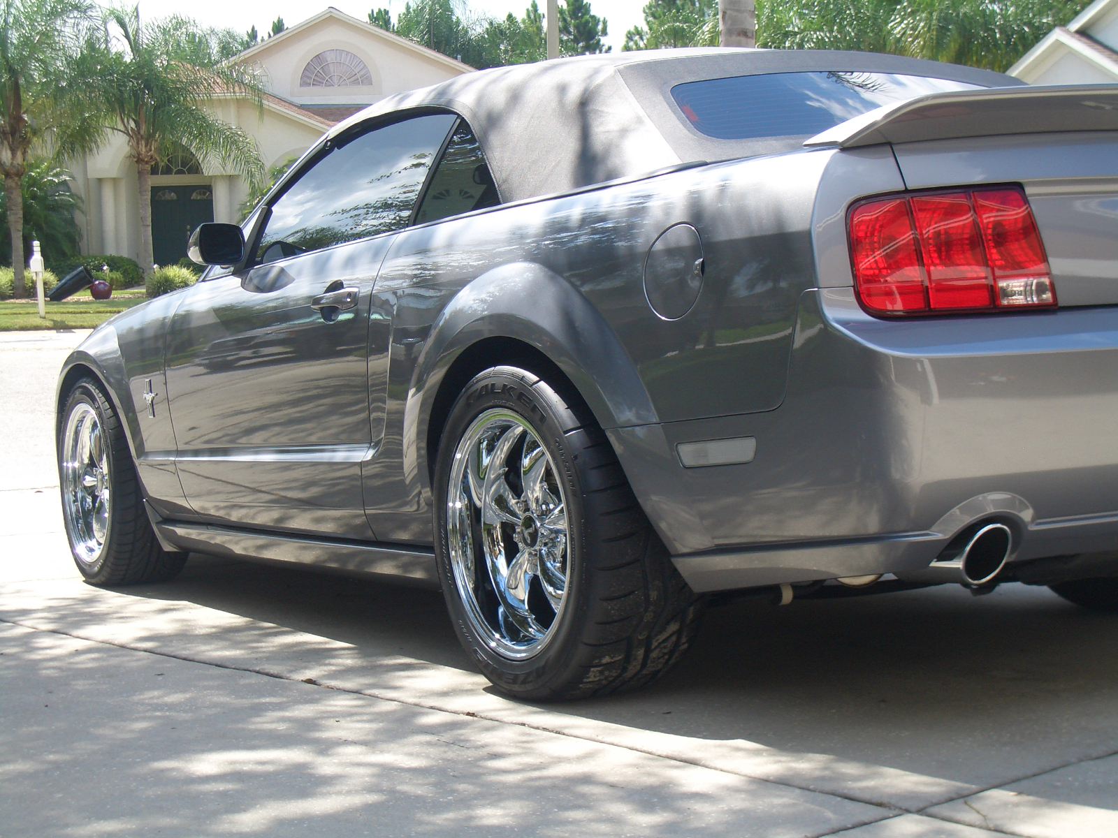

the bulb is clear. I got red leds for my clear sides
Attached Thumbnails Question for those with clear/smoker rear side markers-cimg3077.jpg
