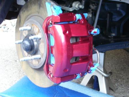

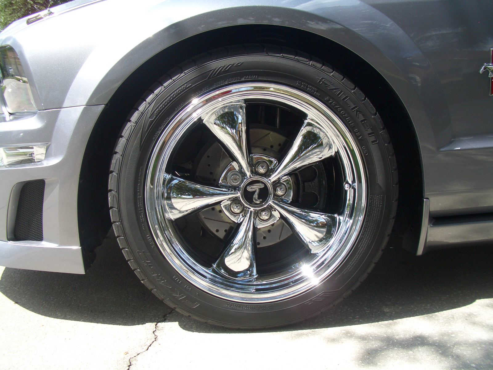

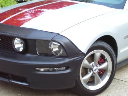

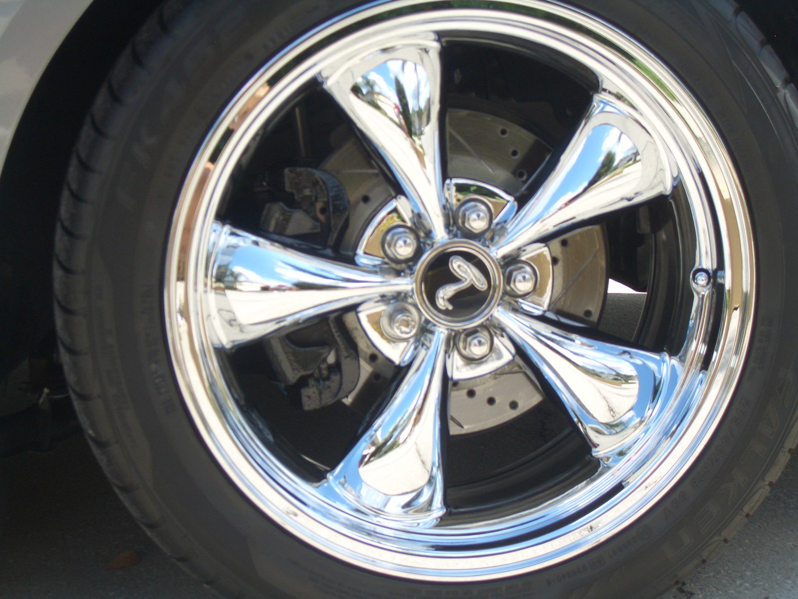

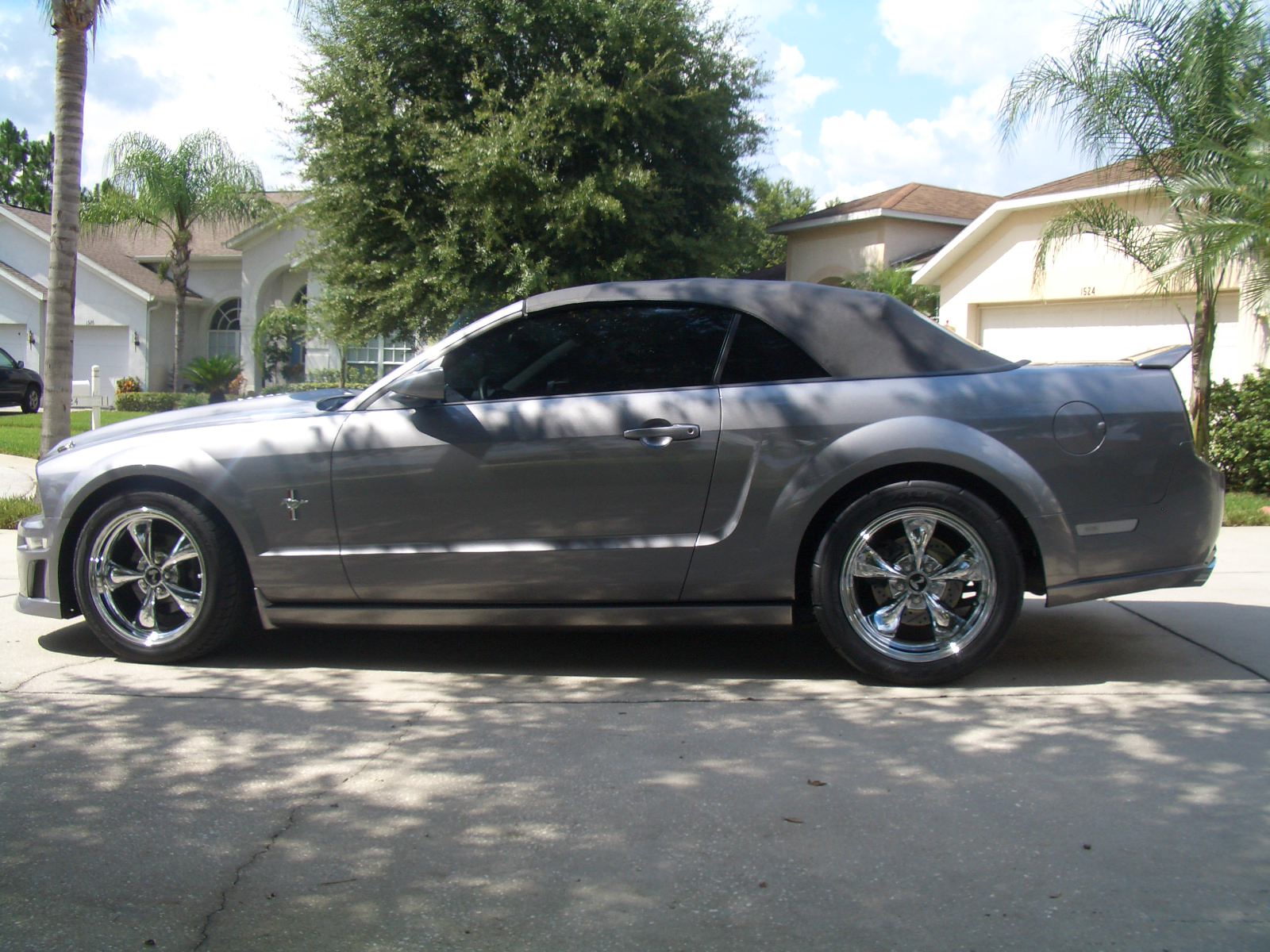

Here are some pics. Shaun, I decided against the stickers. The pony ones had black fingerprints on the sticky side of all 5. I knew they wouldn't hold since the sticky part had been comprimised.Thank you anyway. I'm happy it's done and pleased w/ results. Also got the 295/40 Falkens on
Old Aug 7, 2008 | 09:36 AM
Boltzman's Avatar
Joined: April 20, 2005
Posts: 4,660
From: Tampa,FL
forgot pics
Attached Thumbnails Question about G2 paint-cimg3068.jpg   Question about G2 paint-cimg3074.jpg   Question about G2 paint-cimg3077.jpg   Question about G2 paint-cimg3079.jpg   Question about G2 paint-cimg3069.jpg

DAAAEEEM that looks GREAT
MAN - I love the way those Falken 295s look
