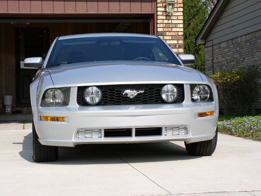

Depending what finish you are looking for textured or smooth. I painted the upper inset and decided that the texture should stay. An alcohol cleaning, taped it off and sprayed with Dupli-Color "Adhevise Promoter", that was all I used for prep. Then body color and clear.

Looks Nice!
