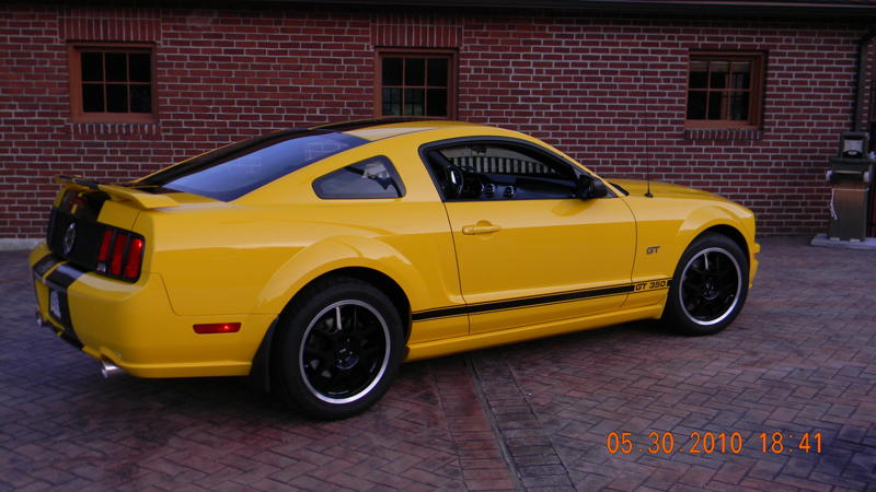

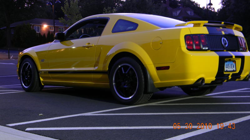

Here's some shots of mine. My car is not lowered and I have the Nitto 555 in 255/45-18 in front and 285/40-18 in the rear. They're the same sizes the '07-'09 GT500's run stock. And they're the same height as the stock 235/55-17 my car came with so no need to recalibrate the speedo. Been driving with this set-up for six years and had ZERO issues whatsoever.

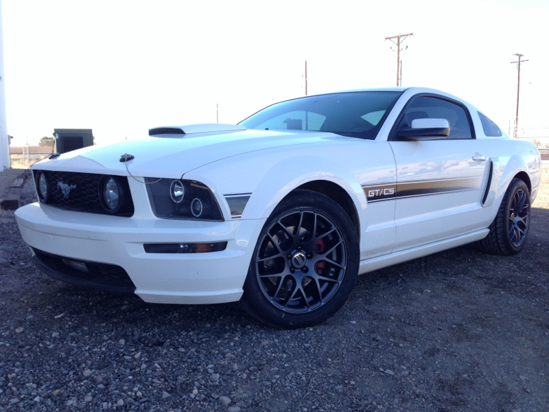

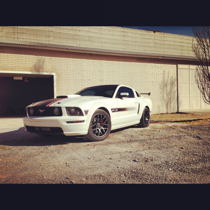

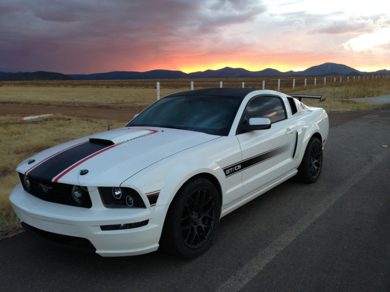

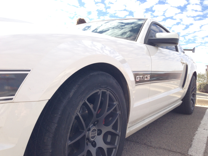

Got 255 on the front and 285 in the back on 18"
Attached Thumbnails New Wheels...-image-3381184170.jpg   New Wheels...-image-122302552.jpg   New Wheels...-image-1142828721.jpg   New Wheels...-image-3678469380.jpg
