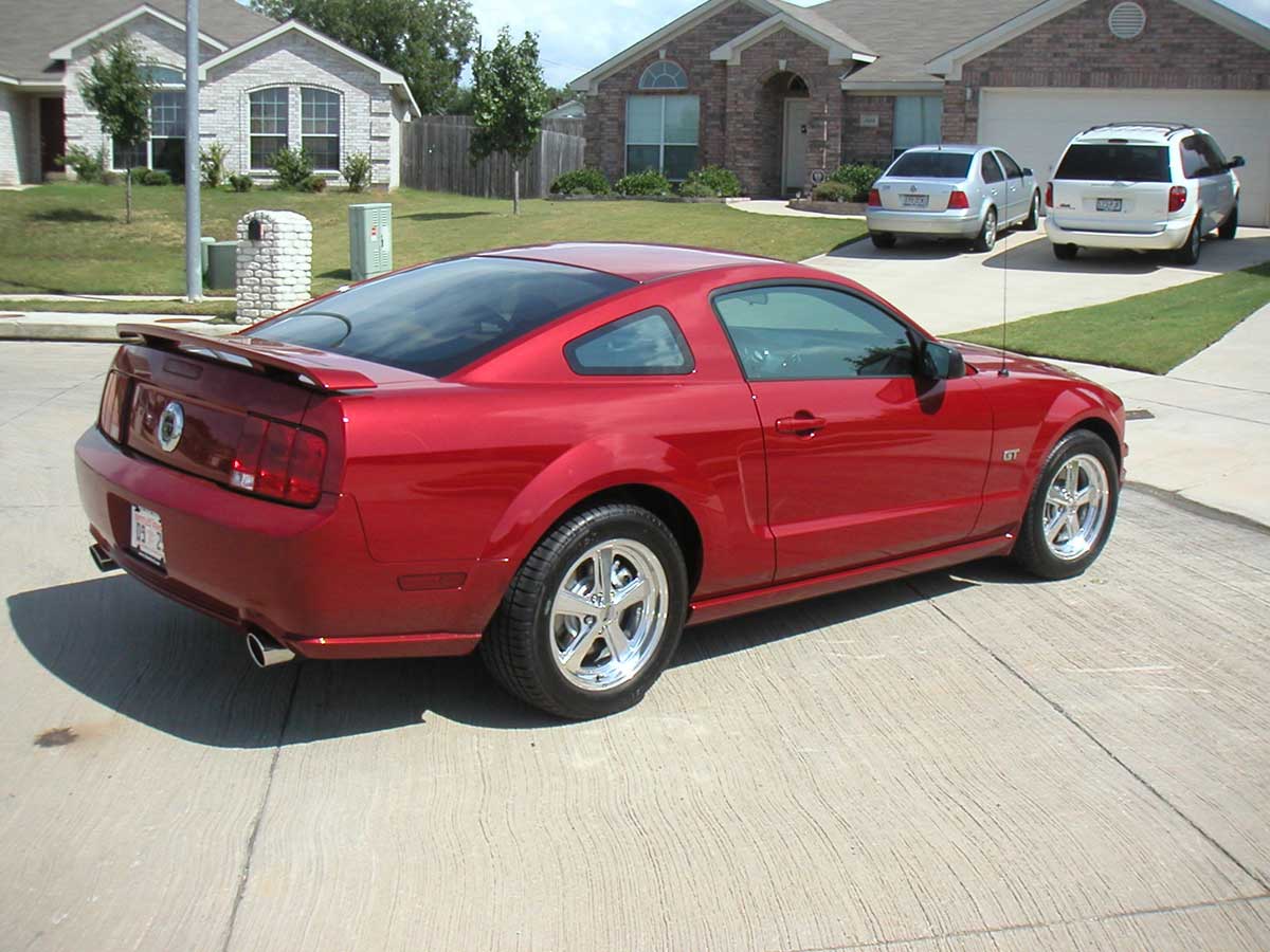

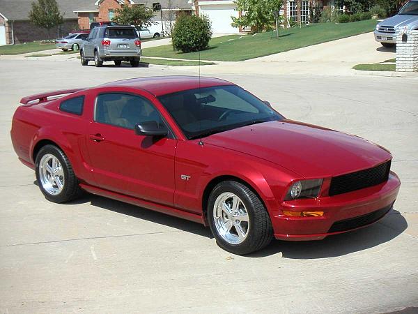

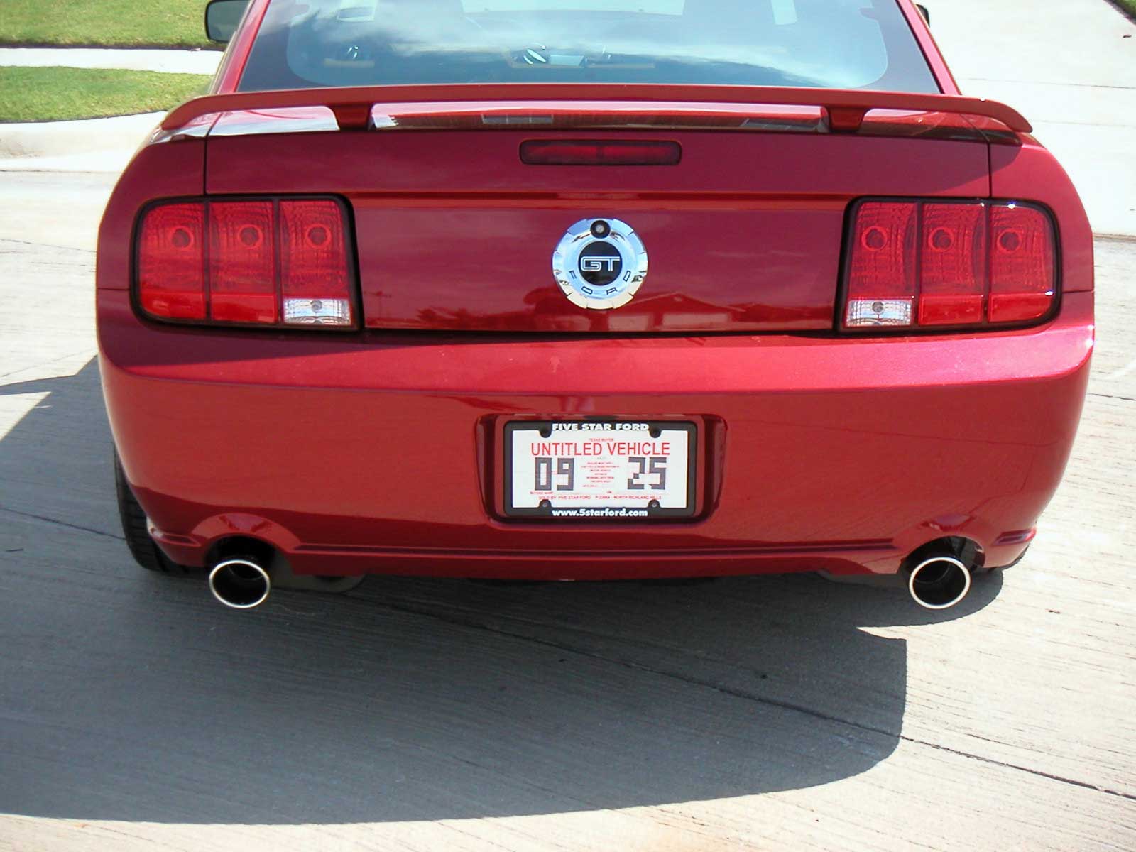

Here's a couple of pics. What do you guys think? Would the GT500 spoiler look better, or the OEM one?

Never the OEM one. A pedestal spoiler is not the right look for S197's, unless you add a ducktail and go for a Mach 1 look. I haven't had one bad comment on mine yet.
