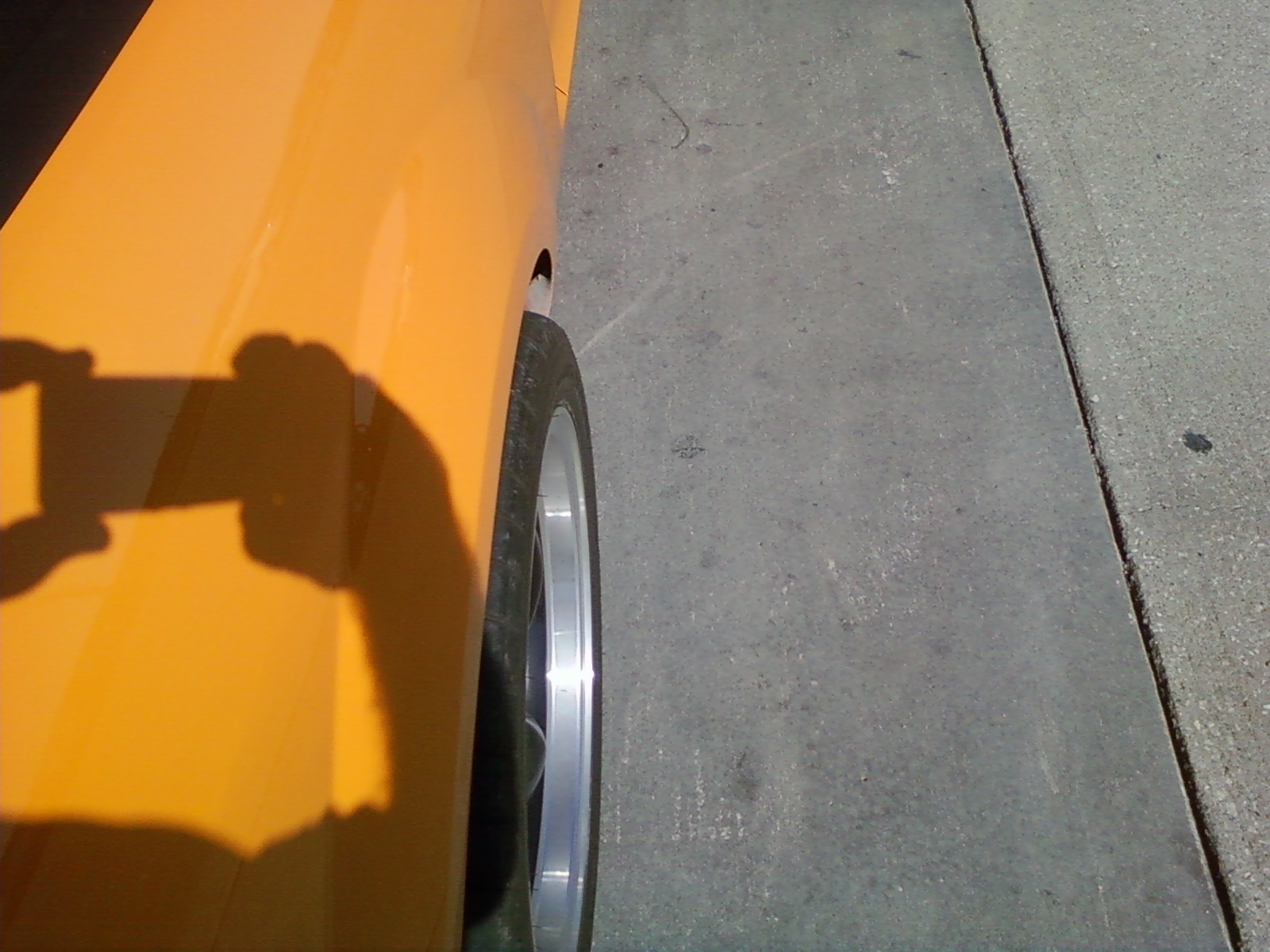

It should look just right if you like the wheel/tire combo sitting about 1/4 inch outside the (top) edge of the wheel well, I'm running 18x10's 94-04 bullitts w/285-35 Nitto 555's
Attached Thumbnails New 17x10.5 SN-95 Bullitts. Will they on the rear of an S197?-sspx0051.jpg
