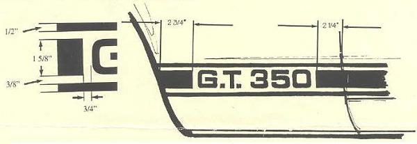

I need to know how wide the center stripe is, how wide the upeer and lower stripes are and how wide the gap between the center and upper. Thanks in advance

See pic:

Originally Posted by StangNut
See pic:
Aren't the top pins actually 1/4" ??? I noticed it showed 1/2"????
Old Sep 20, 2006 | 04:33 PM
AFBLUE's Avatar
Dethroned Nascar Guru
Posts: 10,059
For what it's worth. Graphic express' GT-350 rocker stripes are 3.375" tall.
Which is the same as what Stangnut posted.
1/2 + 1/2 + 3/8 +3/8 + 1 5/8 = 3 3/8" or 3.375"
http://www.graphic-express.com/k145-...de_stripes.asp
Old Sep 20, 2006 | 04:35 PM
Shelbywanabe's Avatar
Joined: August 9, 2006
Posts: 228
Yeah, i just noticed that..... my mistake!
