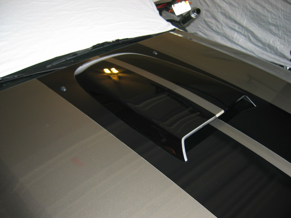

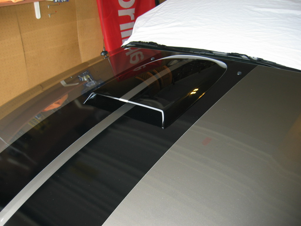

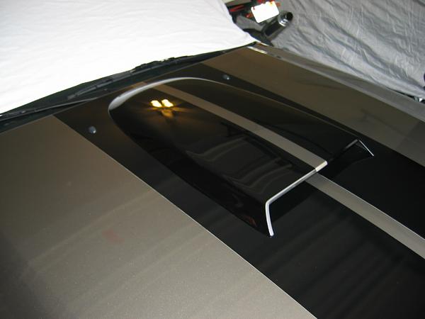

Thank you VERY MUCH for the loan of the instructions and the template. Installation went very easy thanks for the help! Also thanks to GRAYPNY for an awesome deal on the scope. Even the strip matched up pretty well.
Those seven holes seem enormous when I was drilling them. But, all is well in the end and it looks pretty good to me.

Looks great! Glad things went smoothly once you got all the hardware. Looks really good, and at least from the view in the photo, you can't see the stripe issue at all. Can't wait to see it in person.
Did you have to take the hood off to do it?

I didn't feel I needed to take the hood off and the instructions didn't call for it. You do have to remove the under hood liner, but mines been gone for years. I had some towels and leaned on the hood for support while drilling. Also put a sheet under the hood to catch metal shavings. Also used my shop vac to vacuum the metal shavings off the top of the hood instead of brushing/wiping them off since I heard that could scratch the hood, but blowing them off (or in my case, sucking them off) seemed safer.
I also used a tiny Phillips screwdriver and a dead blow hammer to make a tiny indention on the hood, used a small bit and drilled a pilot hole then went back with the (what looked HUGE) larger bit for the final holes.
Overall it was pretty easy. The hardest part was rigging up the hardware since I couldn't find any M4x.7 ubolts at any stores, I had to make my own from some 4mm bolts and u clips.
I might still cut the bolts off shorter under the hood and paint them with some touch up paint. And I'm still throwing around the idea of putting something on the side of the scoop, like 281, or 281SC, or something, but not sure.
