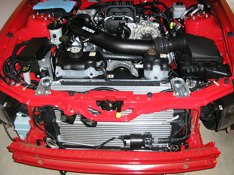

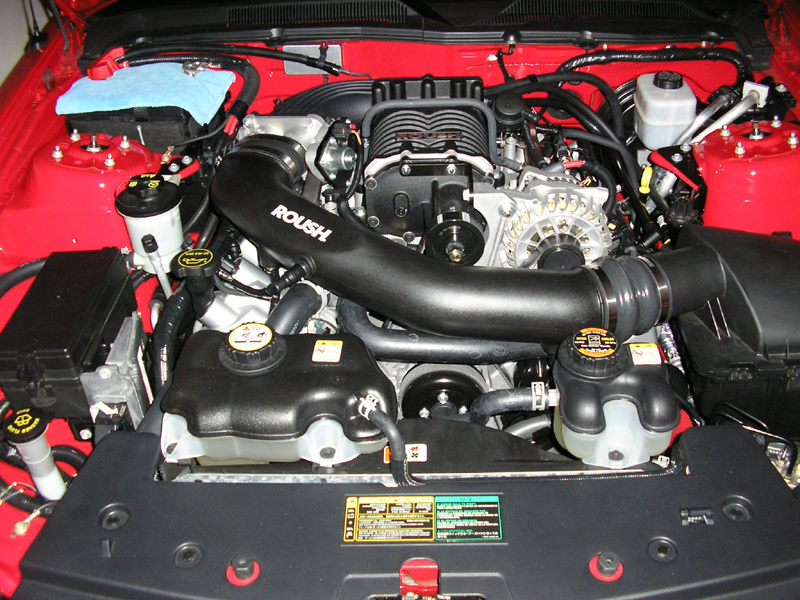

Here are a couple pics of my latest mods:
Attached Thumbnails Lower 0.5"...-engine_front_closer.jpg   Lower 0.5"...-engine_front_done.jpg

What kind of supercharger was that...looked like the roush but with the intake on the other side
It is the Roushcharger, but I used the entire cooling system (radiator/pump/brackets/pre-formed hoses) for the intercooler (minus the GT500 intercooler) from the GT500. My motivation was a clean OE type install without drilling any holes in my car. It turned out really well, IMO. I'm very pleased with all aspects of the kit.
