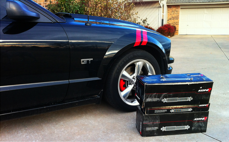

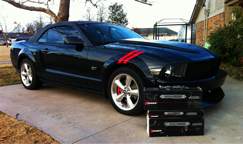

Found them at moss muscle for under a hundred. And look what came this morning!
Konis and springs are in. I just need strut mounts and camber bolts and I'm good to go!

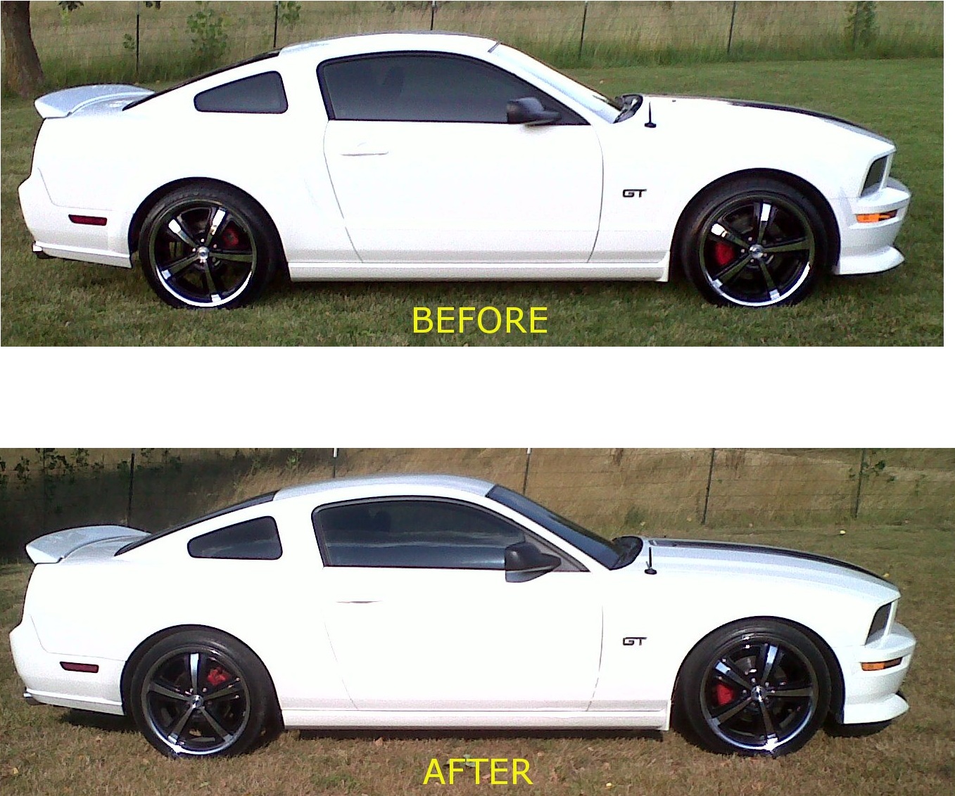

Here are before and after pics of Koni STR-T and SR springs.
Did you do mounts or lcas or relocation bracket or anything else?
Looks great by the way. Love those wheels

I did the GT500 strut mounts, camber bolts and adj. panhard bar. When I took it in for alignment, the camber bolts let it go right into spec. I installed J&M LCAs right after I bought the car because of the stock bushing's constant squeaking. I have BMR lca brackets that I have not had a chance to install yet. After lowering my 60ft time increased because it now unloads the rear tires because of the incorrect lca angle. I have since installed 4.10 gears and Hot Rod cams and 1st, 2nd, and 3rd spin easily. I am looking forward to getting them installed and see what the cams and gears actually do when the rear tires plant instead of unloading.

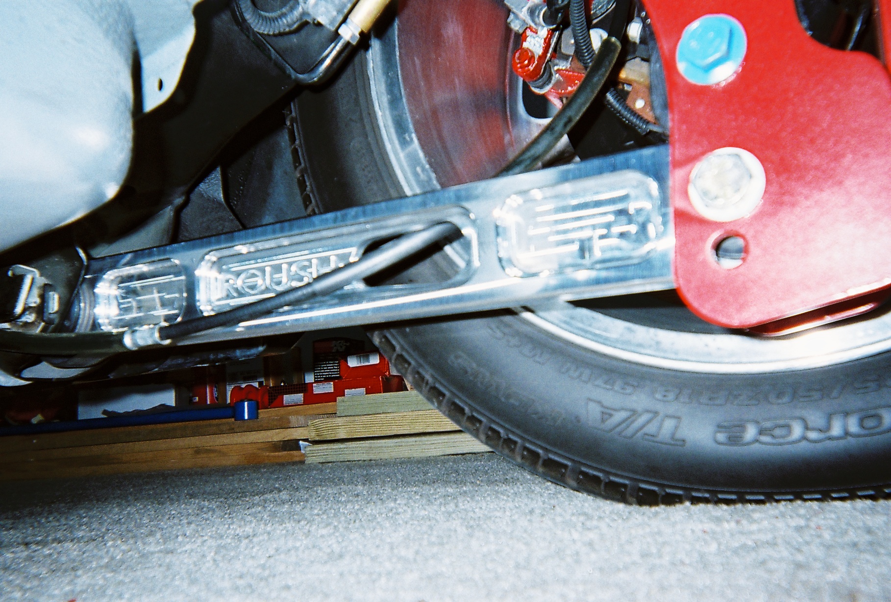

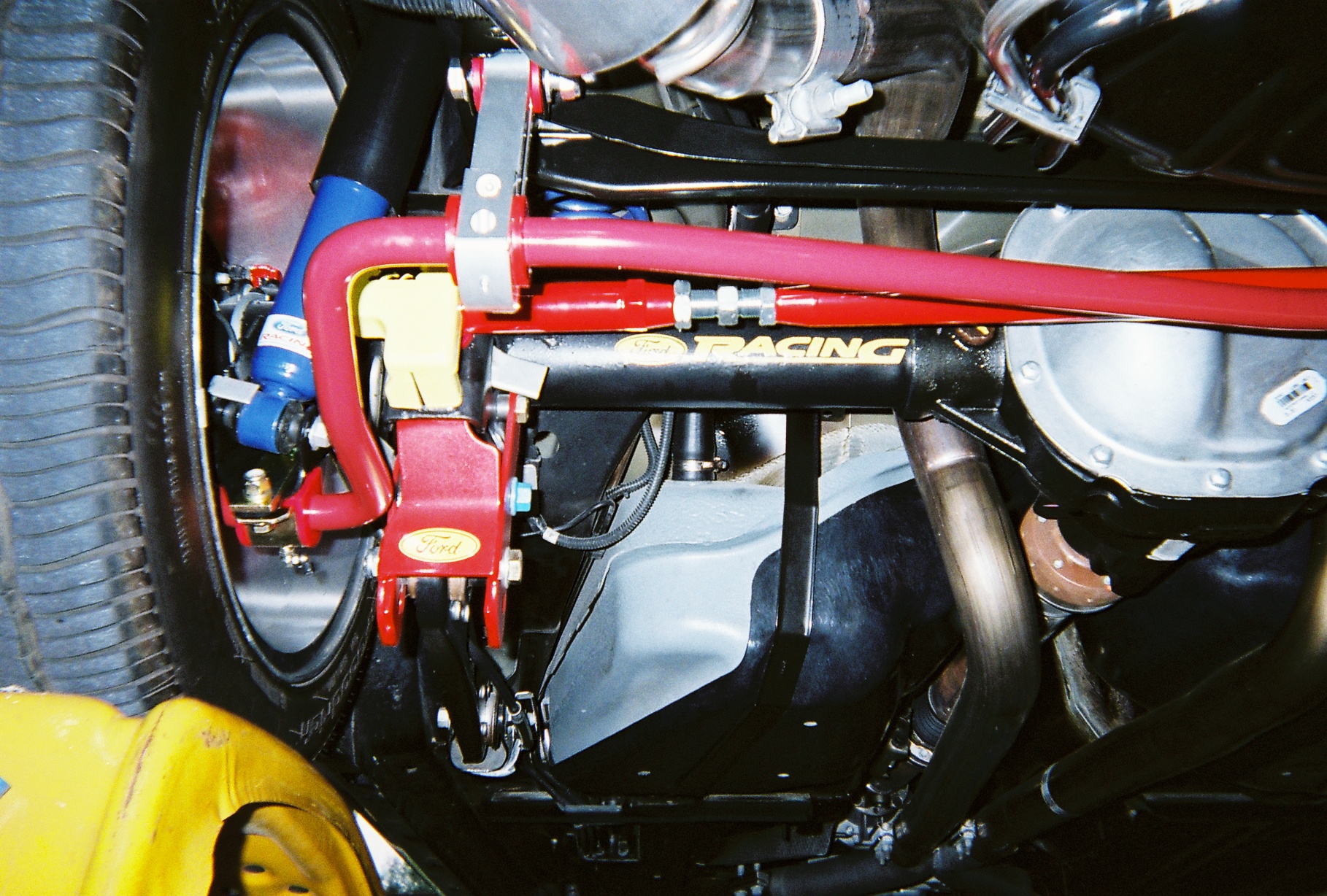

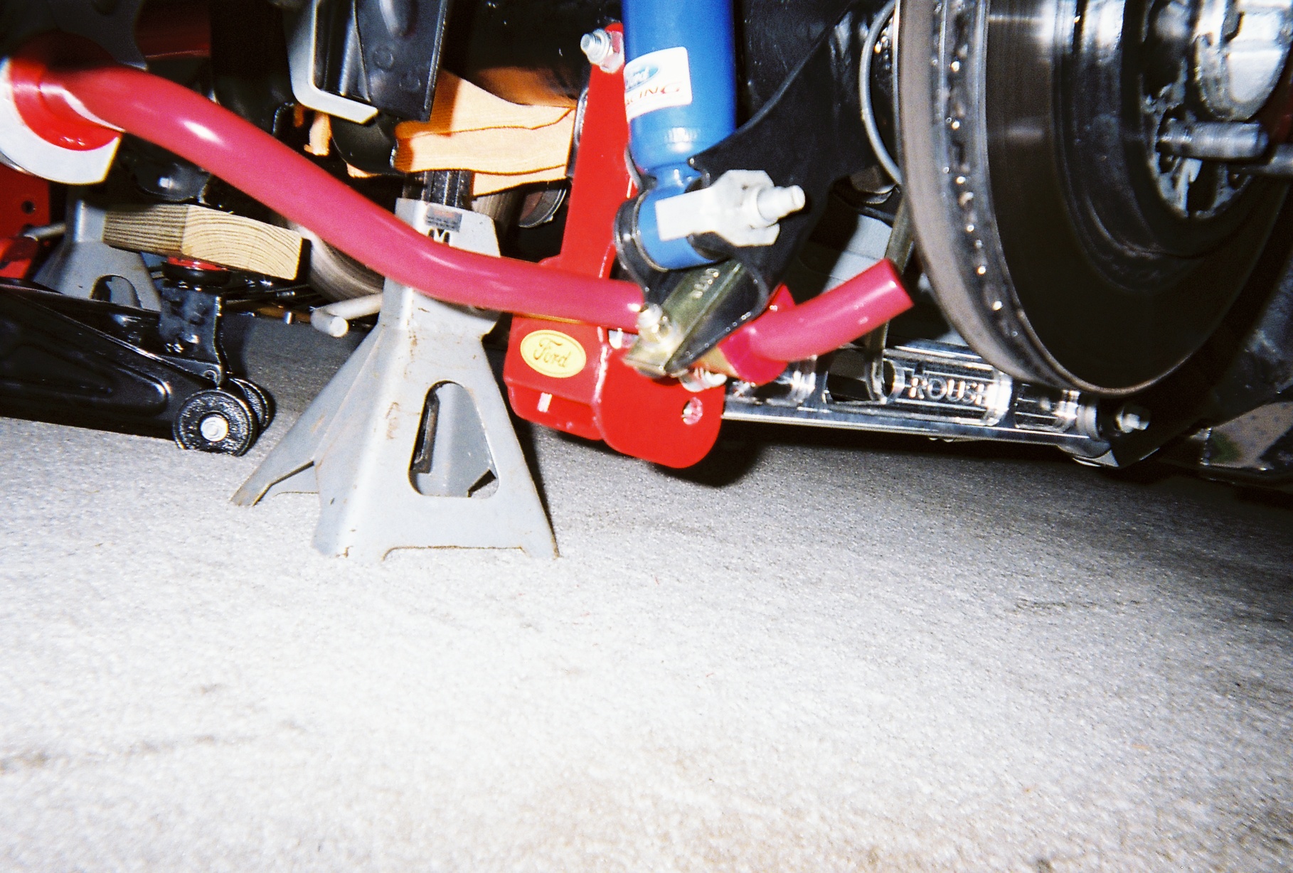

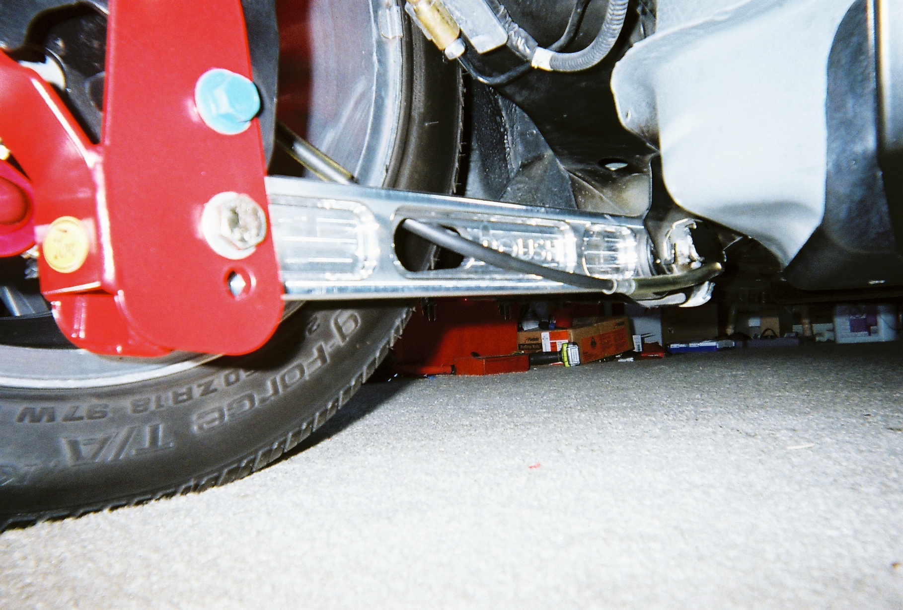

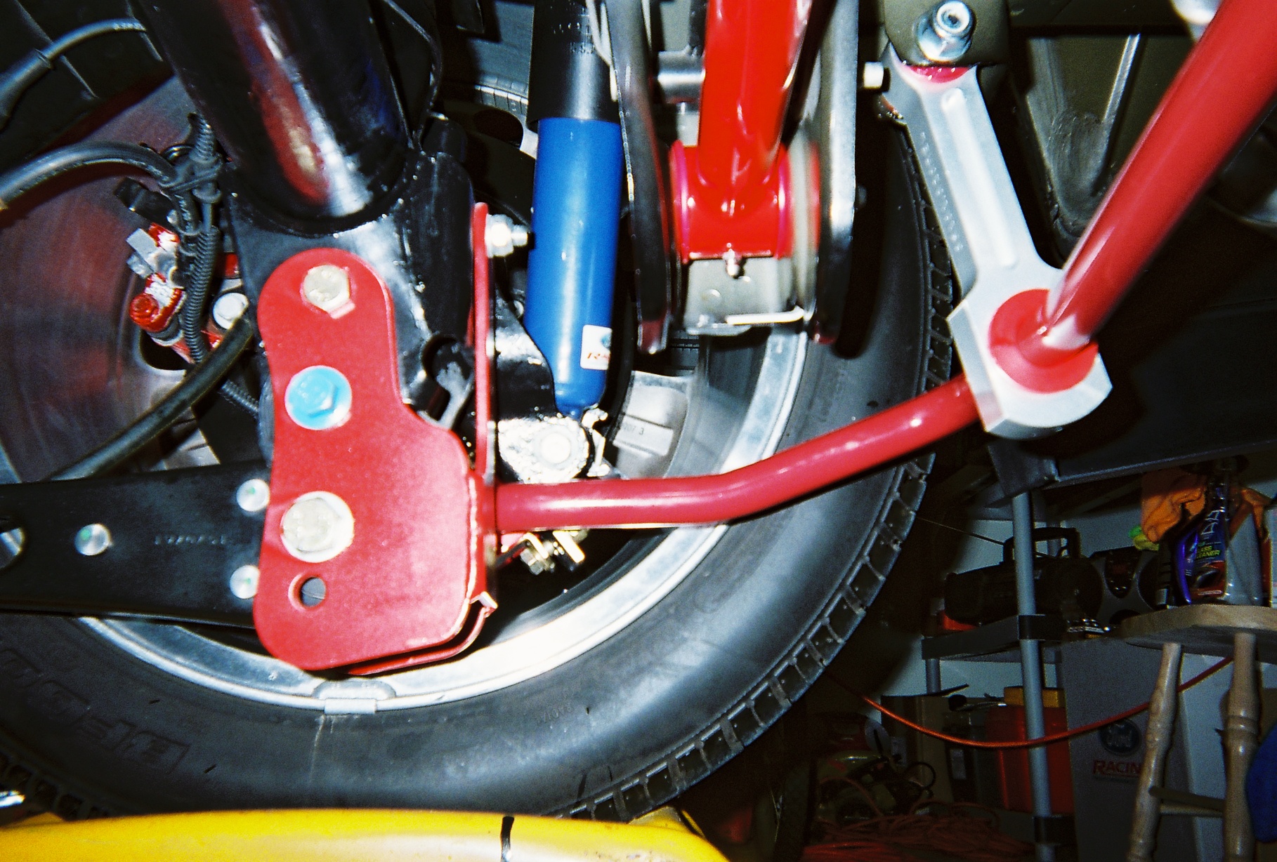

,, YES be sure to do the relocation brackets in the back / rear ,,after you lower the car ,to stop wheel / tire spin ,, K springs and Konis-551454-r1-13-12a.jpg
K springs and Konis-765452-r1-05-20a.jpg,,,
