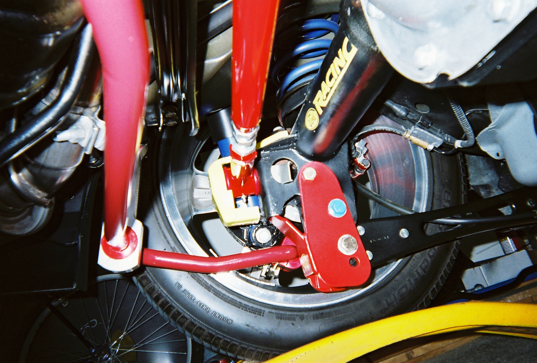

What are others views of progressive vs standard rate springs? I'm thinking progressive since its a daily driver and I just want the look while maintaining the ride. I've opened it up to eibach pro springs as well since they are progressive as well.
Already have koni strts shocks and struts and gt500 strut mounts priced. Just waiting on springs
,, Just saying ,letting you know ,,I have the Ford Racing ( blue ) K springs all around ,,K springs and Konis-002368-r1-11-11a.jpg,,,and after a while the front will drop more ,,but the back will stay as is . ,,all that weight on the front .

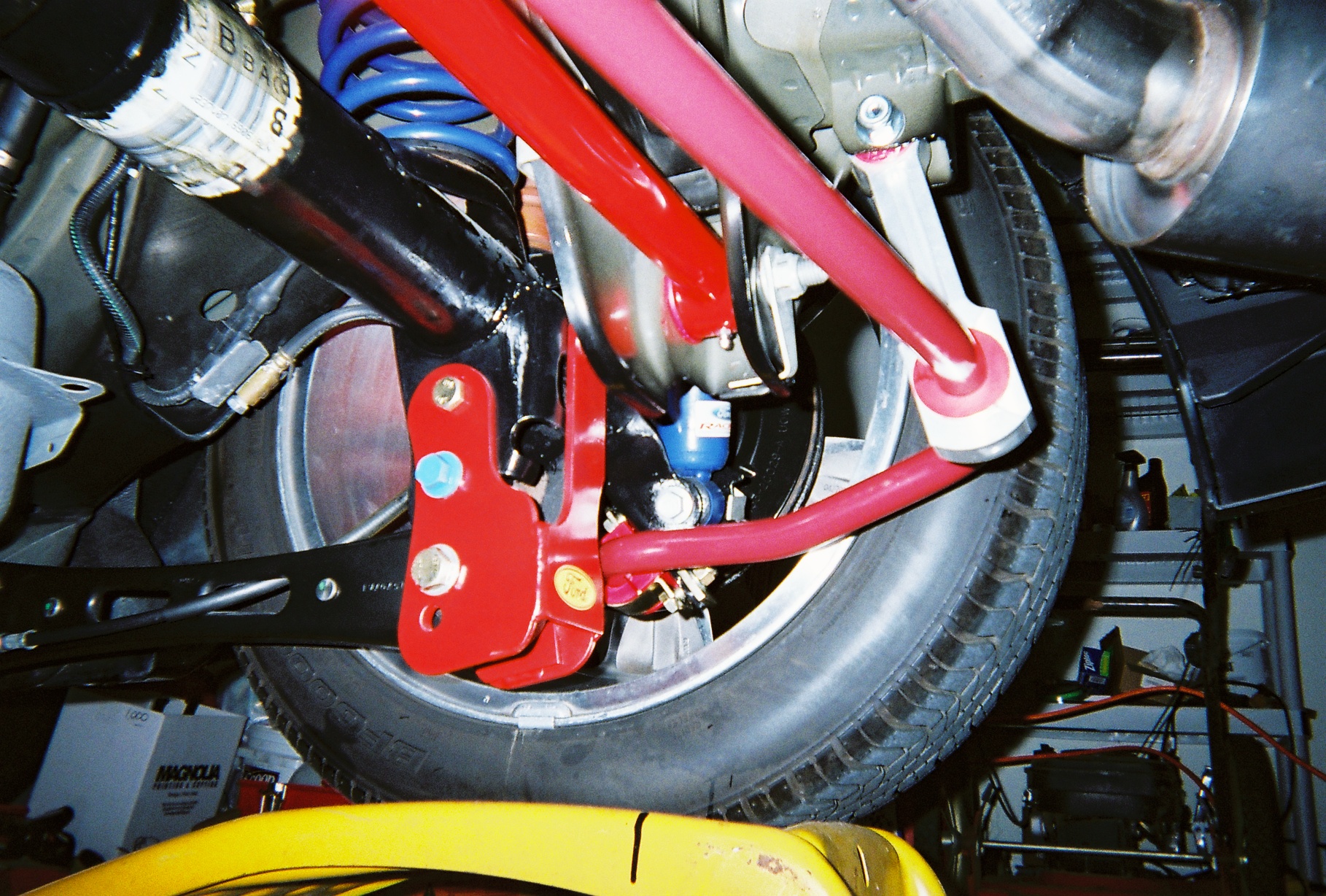

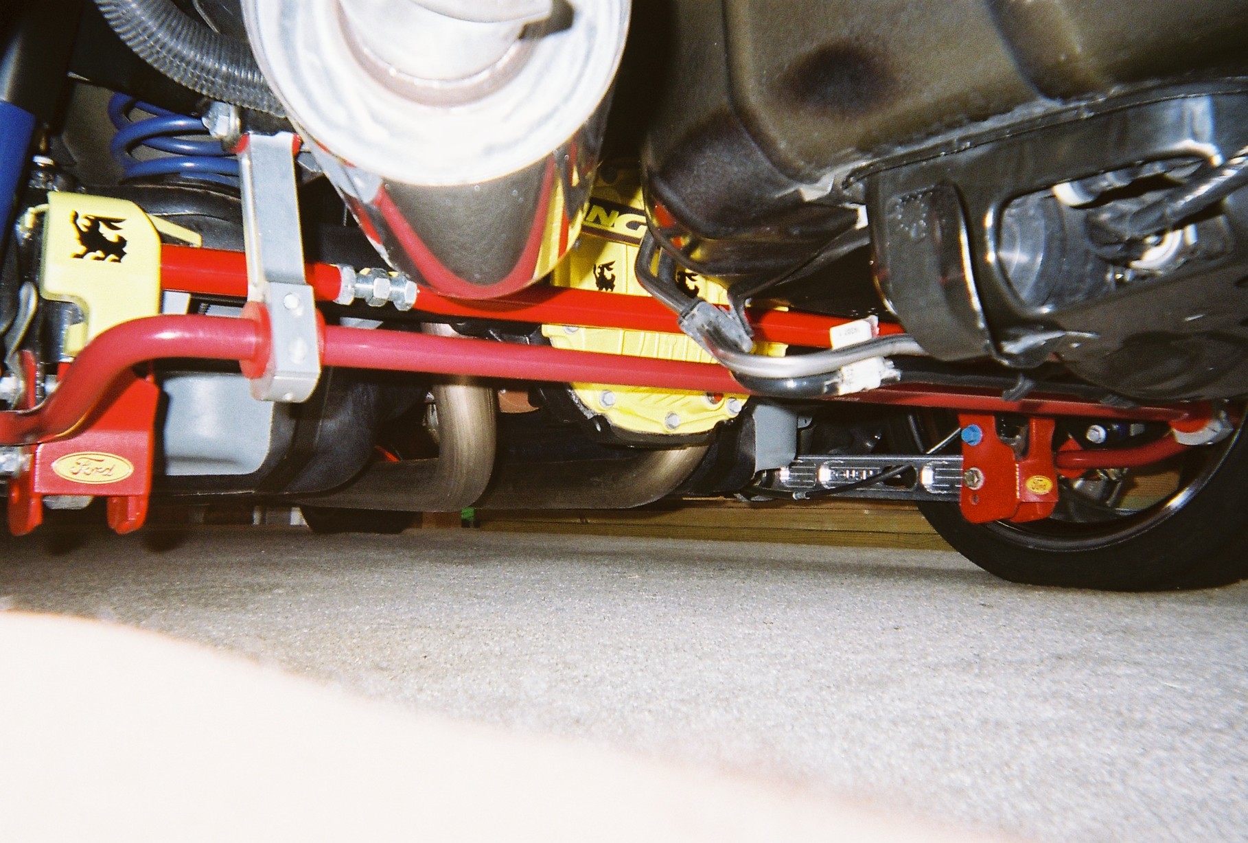

,, Just saying ,letting you know ,,I have the Ford Racing ( blue ) K springs all around ,,Attachment 123949,,,and after a while the front will drop more ,,but the back will stay as is . ,,all that weight on the front .

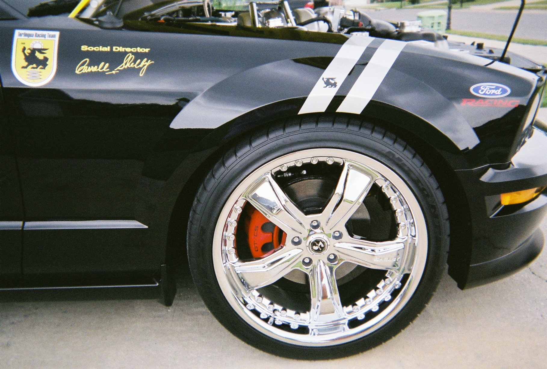

,,,,K springs and Konis-000144-r1-02-1a.jpg,,the front with K-springs
