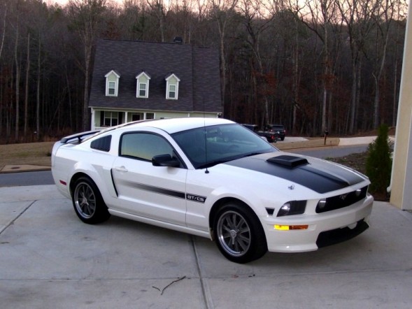

Old Mar 2, 2008 | 07:56 AM
omendez's Avatar
Joined: November 28, 2007
Posts: 97
Make sure the guy that does it has done the black before, the guy that did mine said he did but i have trash in the black, all the other work he did was excellent but the black could be better.
Old Mar 2, 2008 | 09:49 AM
n8rfastback's Avatar
Joined: June 25, 2007
Posts: 2,416
man thats lookin good!!!!
