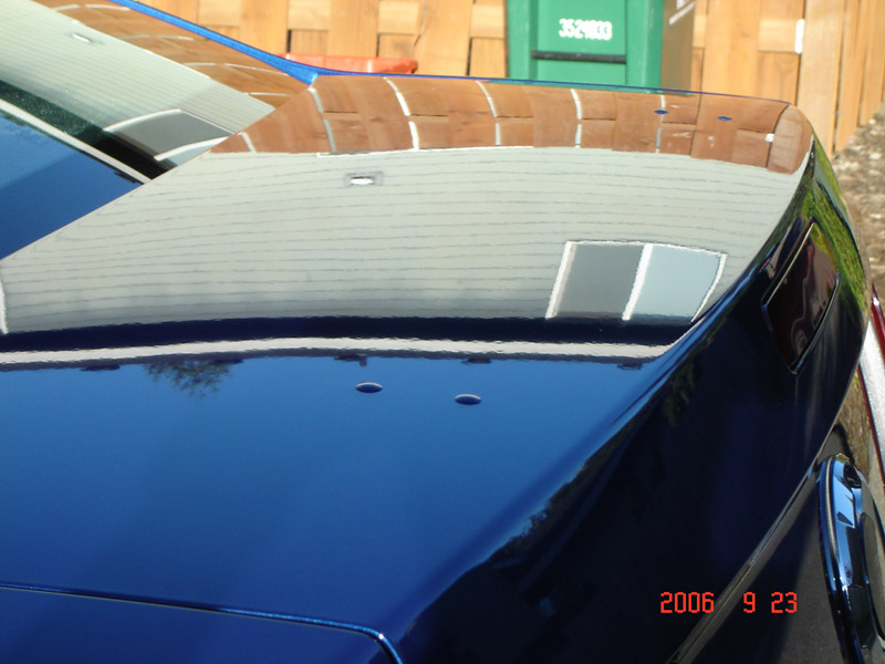

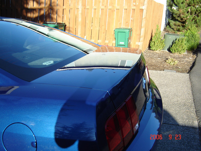

Originally Posted by Fords4Ever
Vermillion, can you repost a picture of your trunk, I can't see any pics in this thread and i am very intersted in deleting my spoiler.
Thanks
Here you go... the plugs have been in 8 months now...
Attached Thumbnails I deleted my spoiler-dsc04044.jpg   I deleted my spoiler-dsc04045.jpg
Thanks! That doesn't look bad at all.

Originally Posted by Vermillion98
Last weekend I deleted my spoiler. I removed the spoiler and plugged the holes with 3/8" plastic hole plugs. I painted the top of each plug with 2 coats of base color and three coats of clear and sealed holes with a small amount of clear silicone. The hole plugs look like factory installed rivets. It looks pretty good for about $10 investment ($.54 hole plugs + touchup paint.) Plus, if I ever want to put the spoiler back on, I can just push the plugs out and bolt it back on.
Looks great! I came across this post a while back and wished the pics were still there. Thanks for putting them back up. I don't know much about painting, I have some touchup paint but where do I get the clear from? Is it a spray? I'm also wondering if the silicone will be too harsh in the long run. I might do this on Saturday!

Hey, another question- Do you have an up-close pic? This is by far the cleanest spoiler hole plugging I've seen.
Now you can tell you friends that your GT was an ex-police car...
