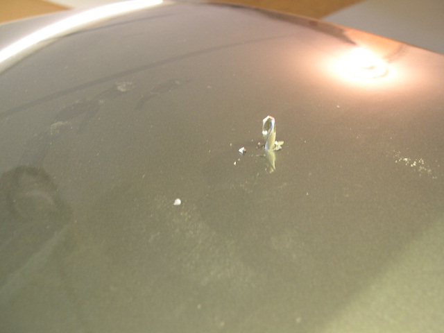

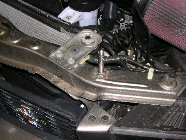

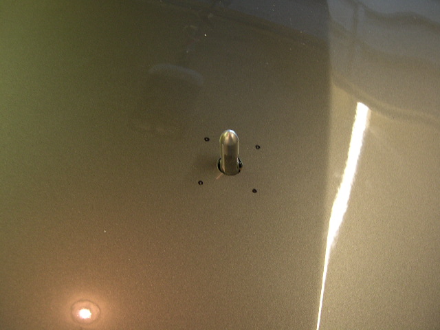

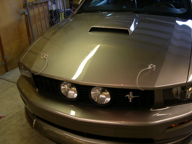

Here's are some how to's that helped me alot. I have the Ford Racing pins and like them very much. I you install them like I did you will not have any issues with length.
HOOD PIN INSTALLATION
The placement of the pins is what is critical...Eric R's pin's are in the best place just like the pictures I posted in your other thread on the same topic. You have to carefully lay out your pins on each side of the flat plastic radiator cover. It is 1/2 inch from the edge of the shroud to the centerline of the pin ( that will put the holes in your hood 2 1/2 inches-center of hole- to the inside of the creases in your hood) After you get your pin's installed perfectly, cut a notch in your felt hood liner where the pin's touch. Then dab a little paint on the tip of each pin, then gently lower your hood on top off the pin's. Bingo, two perfect mark's to drill... Start with a very small sharp drill bit and drill a pilot hole from the underside off the hood. Then go to larger sizes and drill from the top side. A sheet metal "step bit" is ideal as it leaves a nice chamfered edge. 5/8 this will be your final hood hole size. I did not use the bottom plates for the hood because of the hood shape on the bottom side. If you tighten them at all it will dimple the hood.
I used a short sheet metal screw. Drilled a hole along the inside flange where the front cross member meets the side. Looped the cable on the screw and inserted screw. That side is not coming loose. The other loop gets put on the pin against the flex ring. The ring goes in the post from the outside going in. 5/8 inch hole is all you need. I ended up using a counter sink bit. 5/8 wide and 3/4 inch long. Worked great. I was warned, correctly to be careful screwing the plate down. The hood bends veryeasy. So much so that I had to abandon using the lower plate. I used machine bolts of 3/4 inch length and put washers on both inside and out and two nuts with locktite on the underside. Still be careful tightening the top plate. I eased that problem somewhat by using thin rubber foam, from a craft store. Comes in 8 x 11 inch sheets. it is about 1/8 inch thick. I cut a pattern to match the top plate and used it as a gasket between the car and plate. Cut an x in the center for the post to come out of. Works like a charm!
My hood pins are in the exact same spot. They are approx. a 1/2" away on each side of the flat plastic radiator shroud, on the cross member that the rubber hood stops are on. I didn't weld them on I used a 1/2"x 1" bolt w/ the same thread size as the FRP post. I put the bolt (1/2"x1") through the bottom of the cross member in the hole I drilled then used a tall (regular) 1/2" nut. There was enough threads left in the nut to screw the FRP post into. I double nuted it and used red lock tight, solid as a rock! Just an alternative to welding them in.
One wire gets looped into the pin next to the big flex ring. The other goes under the hood and to where the front and side upper framework meet, where I drilled a hole and inserted a machine screw that had a head with a washer all in one piece. I looped the cable with the screw before inserting the screw. It cannot come off without breaking.
Attached Thumbnails Hood Pins-78.jpg   Hood Pins-79.jpg   Hood Pins-80.jpg   Hood Pins-82.jpg

Use the existing holes in the radiator bracket next to the outer rubber hood stop.
The bottom nut and washer (on the pin) will be inside the radiator support bracket. You need to enlarged the bottom hole from the under side of the support to get the nut and washer in and use a socket to tighten the pin. I used a Dremel with a carbide cutter. Paint the exposed metal with primer or touch up paint to avoid future rust. Install your pins and finger tighten them so you can mark the holes for the hood.
Put some wet paint on the tips of the pins and it will mark the location on the hood for you.
Take your time drilling the holes. Start small and align your pins as you go. Don't drill through both inner and outer hood at the same time, the pin location changes as you drop the hood.
The inside hole must be larger. Once the holes are completed lower and latch the hood so you can start on the Chrome circles.
I also added a rubber gasket between the hood and the chrome circle.
I just took an old inner tube and cut it to fit. I left the center hole tight to help keep water out.
Align the chrome circles and dill a pilot hole for one screw. Start with a small hole until you get a hole size that will allow you to screw them in without cracking the fiberglass. Drill the rest of the holes and install the rest of the screws.
