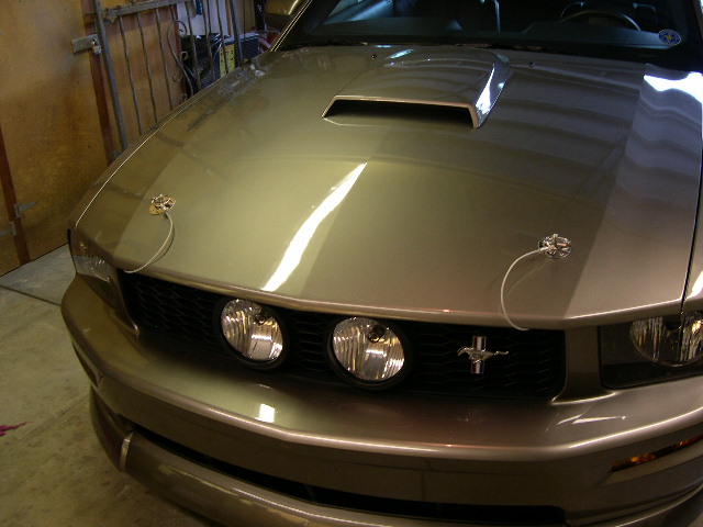

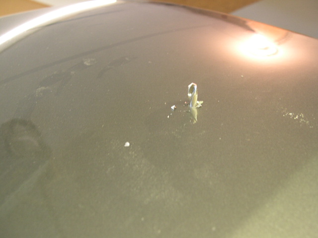

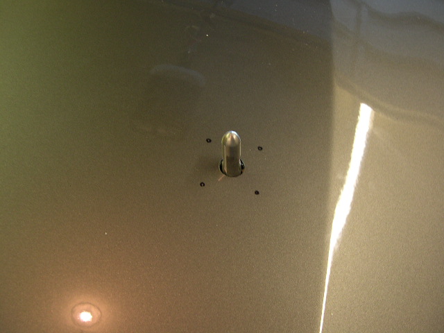

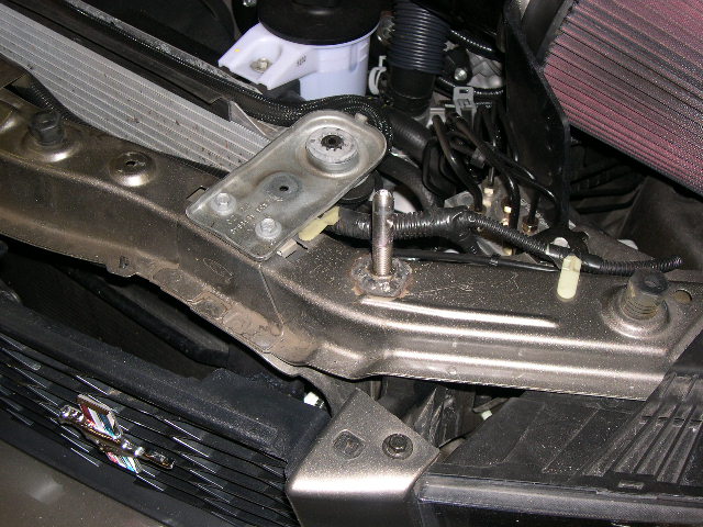

You can do it yourself.
Attached Thumbnails Hood Pin Install-205.jpg   Hood Pin Install-204.jpg   Hood Pin Install-206.jpg   Hood Pin Install-207.jpg

That's a very good "how to"! I didn't use the bottom of the 2 pieces because it can cause you to dimple your hood if you overtighten the 2 pieces together. You can't see it anyway because of the hood blanket.

Rich,
It looks like you welded the upper nut to the cross member ?
No lower nut ?
