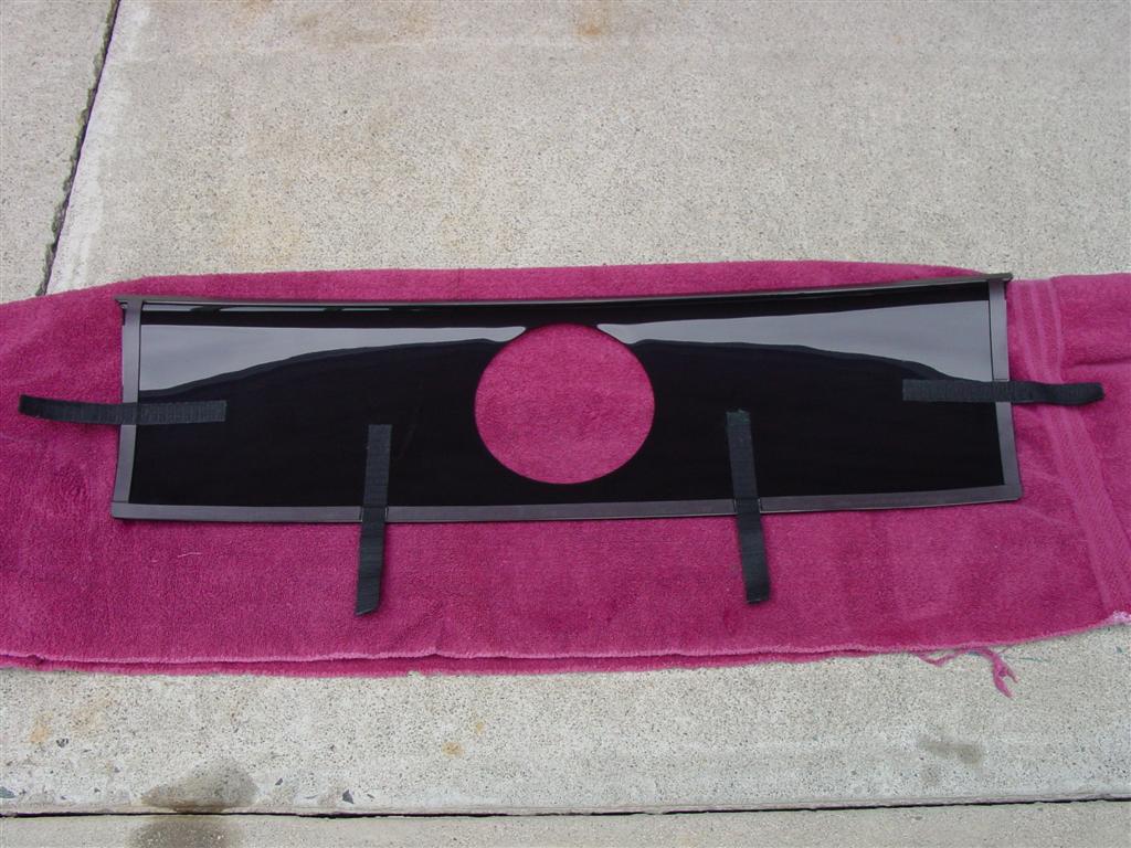

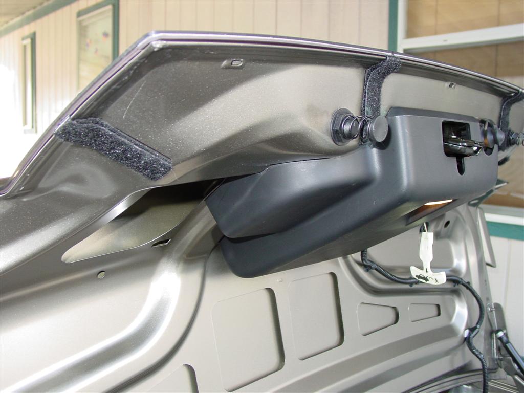

I did it awhile back with the Xenon panel, but not the honeycomb....Worked great. The Xenon panel came with 3M tape around the perimeter for attaching, so I just used that 3M tape, and layed the magnetic tape on top of it. But, the weight of the panel to me was a bit too much for the perimeter magnetic tape to securely hold, so I added four strips of velcro to it as well. This also secured the panel a bit better from a easy theft standpoint. Had it on for some time, and it was always nice to be able to remove for washing....or for just changing up the look once in awhile....
